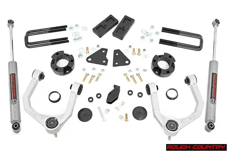

Rough Country / Skyjacker / Superlift:
Sell a 3.5-inch lift kit with new upper control arms, a strut spacer and provides brackets to relocate the front differential. They also provide templates for cutting and drilling the factory differential mounts so you can bolt their differential mounts to them. The Rough Country kit has forged aluminum upper control arms while the Skyjacker and Superlift kits have tubular upper control arms.

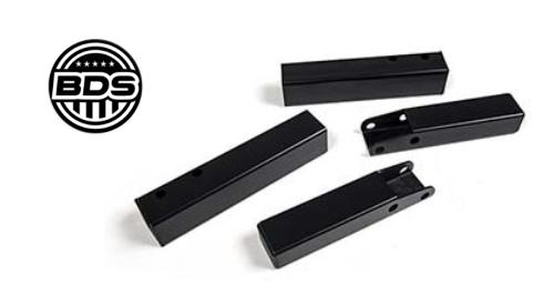

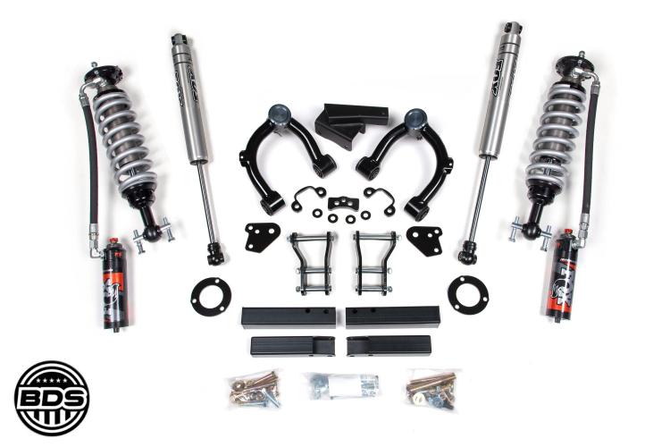

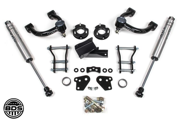

BDS:
Sells a 3.5-inch lift kit with new upper control arms and either a strut spacer or new longer struts. They also include barckets to relocate your front differential. Some of their kits also offer a replacement intrusion beam to allow for larger tires. BDS also offers their intrusion beam separately.

I was surprised that some of these companies provide brackets to relocate the front differential and others do not. The Rough Country and Skyjacker kits look almost identical except that the Rough Country kit has forged aluminum upper control arms. The Superlift kit has different brackets for the front differential than the Rough Country and Skyjacker kits. The BDS kit appears to have the same style of differential brackets as the Superlift kit. The BDS kit also uses a longer shackle to lift the rear instead of a spacer block like Rough Country, Skyjacker, and Superlift does.
I also noted that only BDS, Calmini, and Icon are offering kits with a longer replacement front strut. Only BDS, Fabtech and ReadyLift offer a replacement intrusion beam for more tire clearance.
I also like how Rough Country has plastic caps to cover the top of the joint in the upper control arm to keep the grease fitting clean.

I see that the Rough Country kit has forged aluminum upper control arms while the Skyjacker and Superlift kits have tubular upper control arms. I wonder why Rough Country went with the aluminum, and if there is an advantage or disadvantage?
I'm a big fan of the forged aluminum arms. It'll be the pair I go with in the future. However, the uca doesn't see the sorts of stress that the lca does.. so I'm sure it really doesn't matter all that much.
