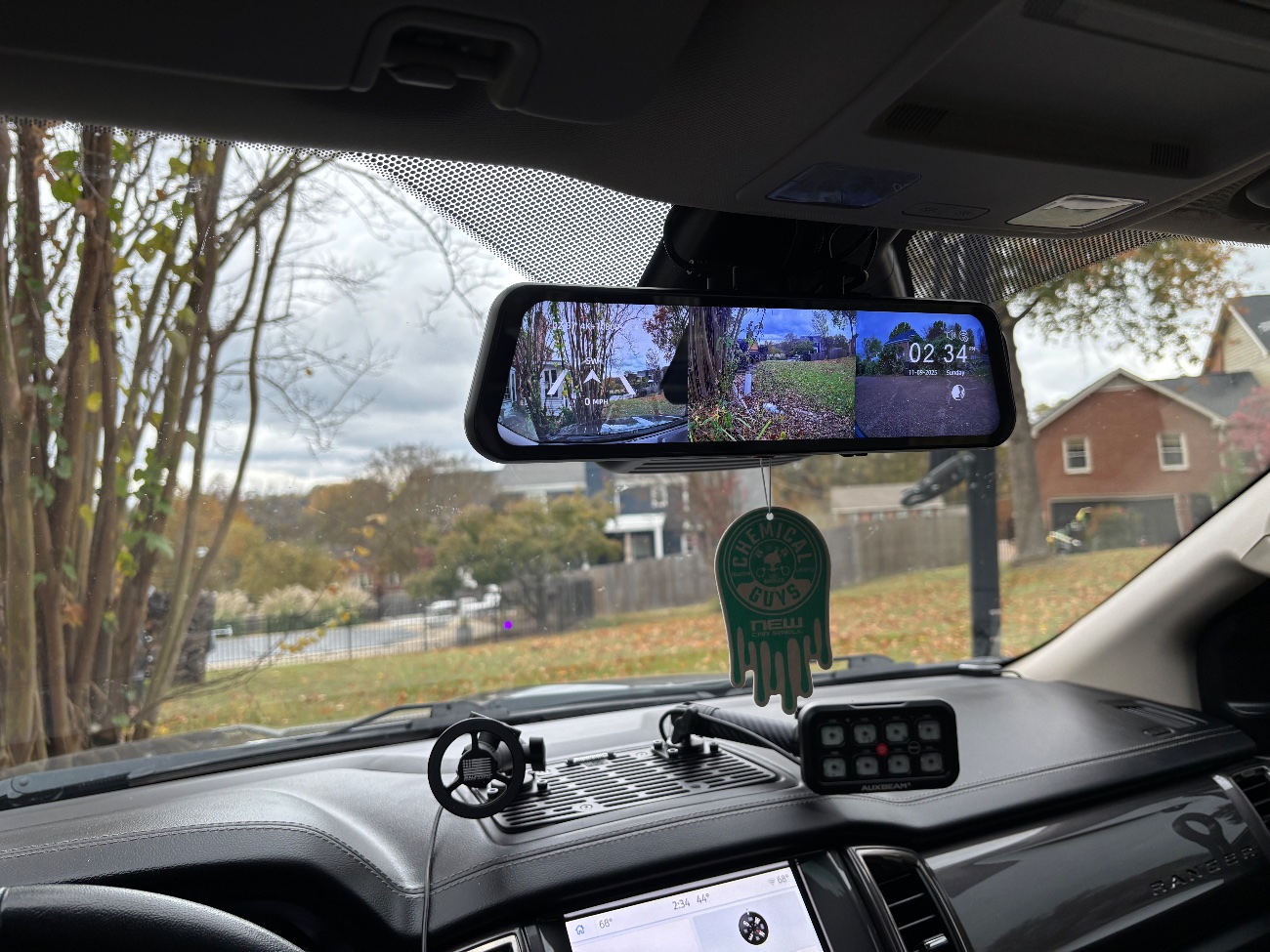

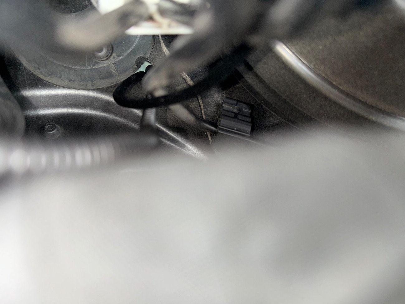

It’s hard to see, but I drilled a hole through the firewall large enough to pass the switch control cable between the switch and the control box. You can get at it from inside the drivers footwell, to the left of the break pedal.
2019-2023 Switch Panel Installation
You can easily remove the driver AC vent and pass the cable next to the radio and ultimately through the back of the change tray on the dash.

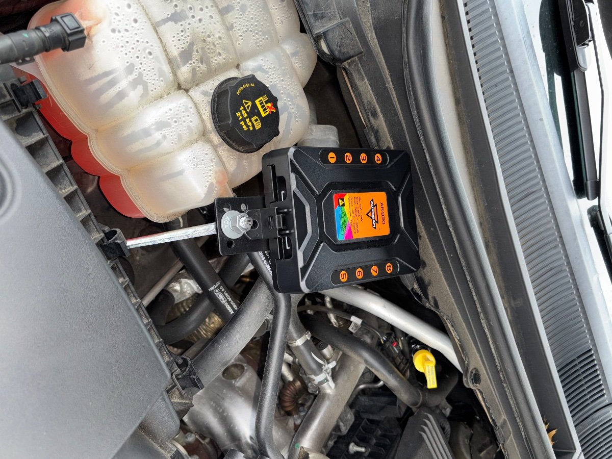

Close up initial mockup.

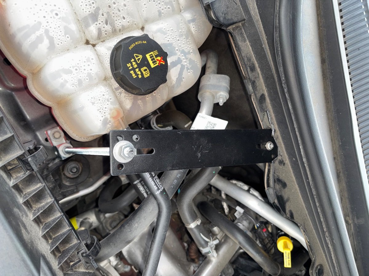

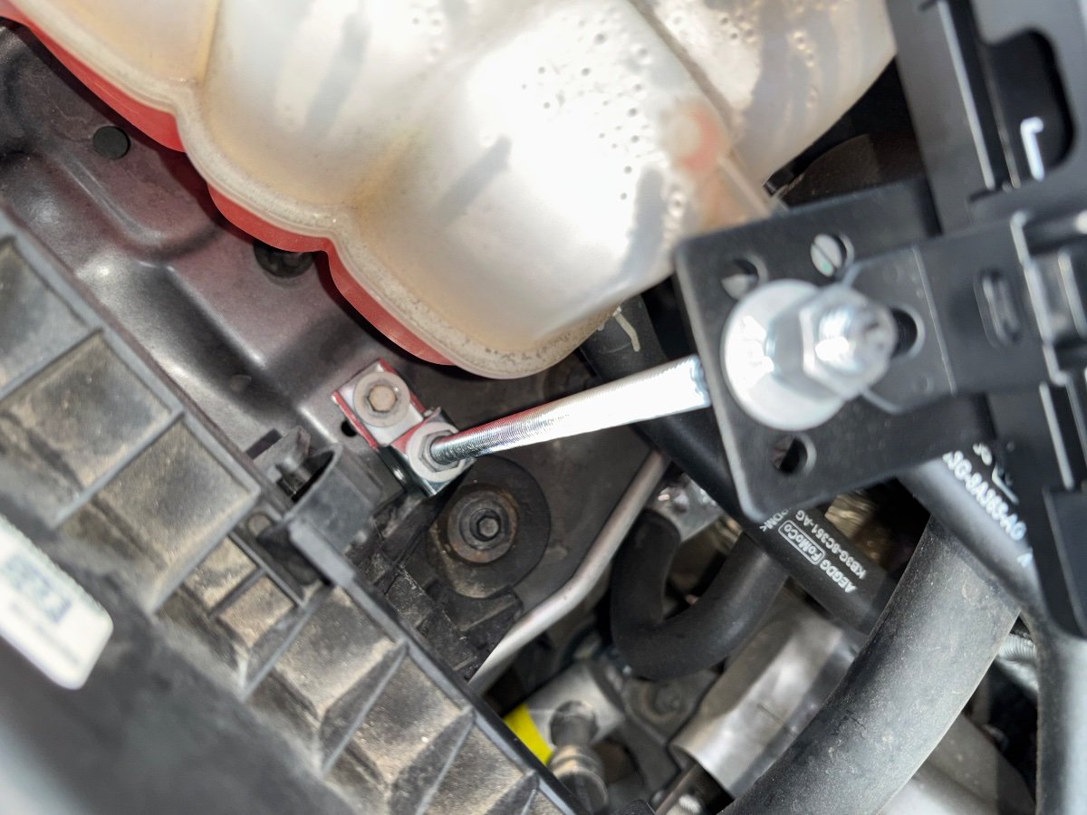

I fabricated an attachment foot out of square tube with punched holes. It is attached to an already existing treaded mounting point under the overflow reservoir. I put a nylon washer sandwiched between 2 rubber washers under the foot for some vibration mitigation. A piece of all thread is used between the foot and the control box mount.

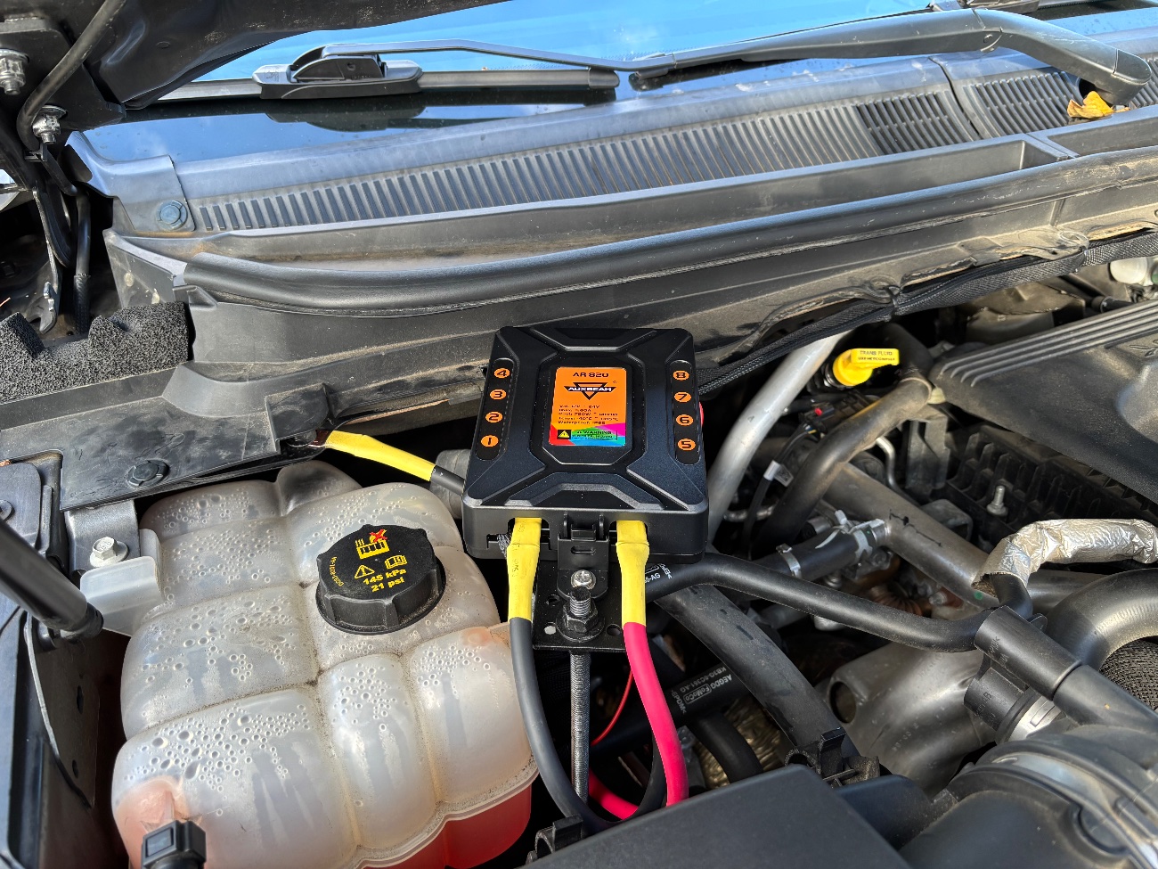

The mount plate shown came with the switch control box. It is attached through an existing hole in the drip edge just below the hood seal.

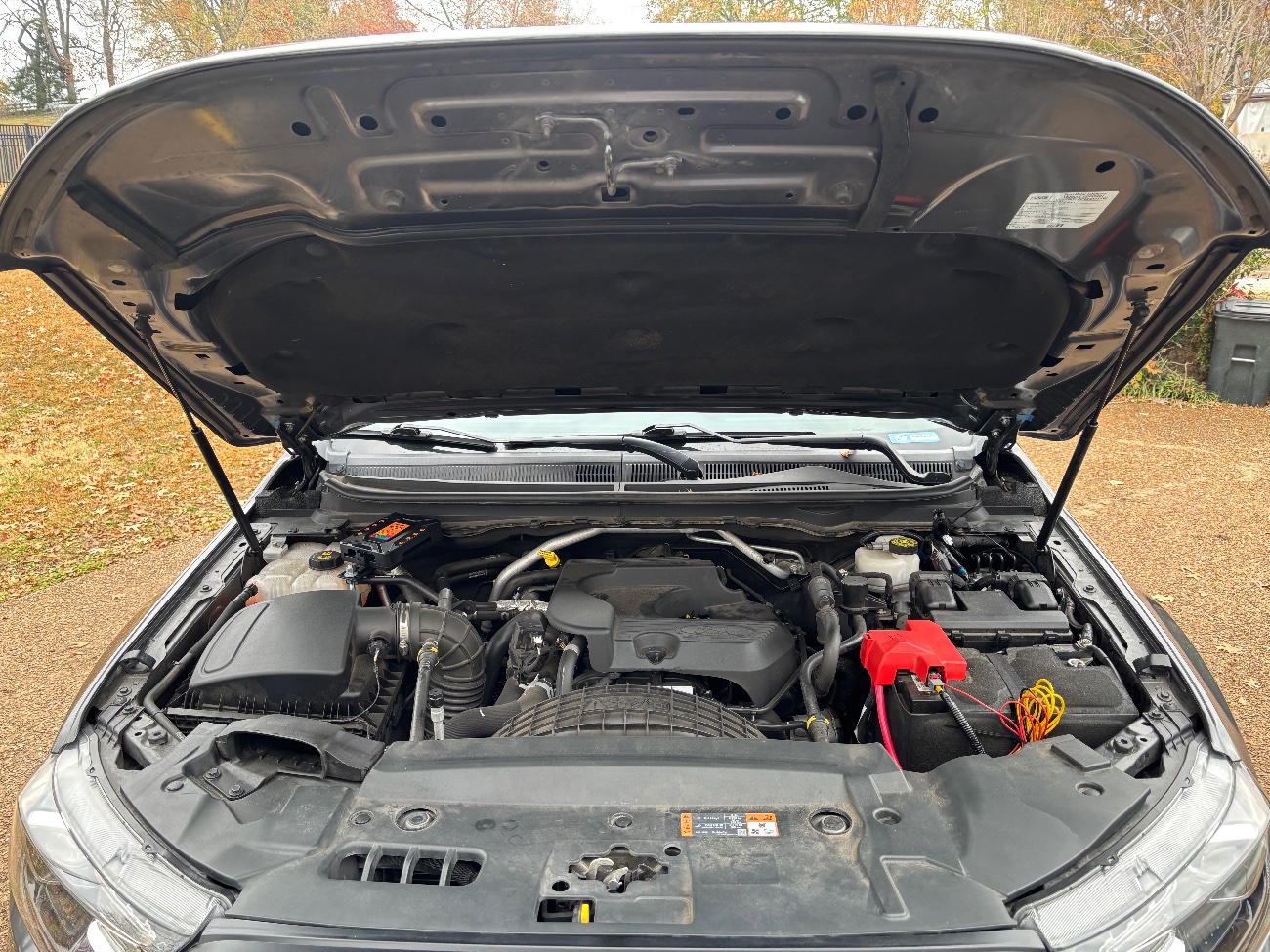

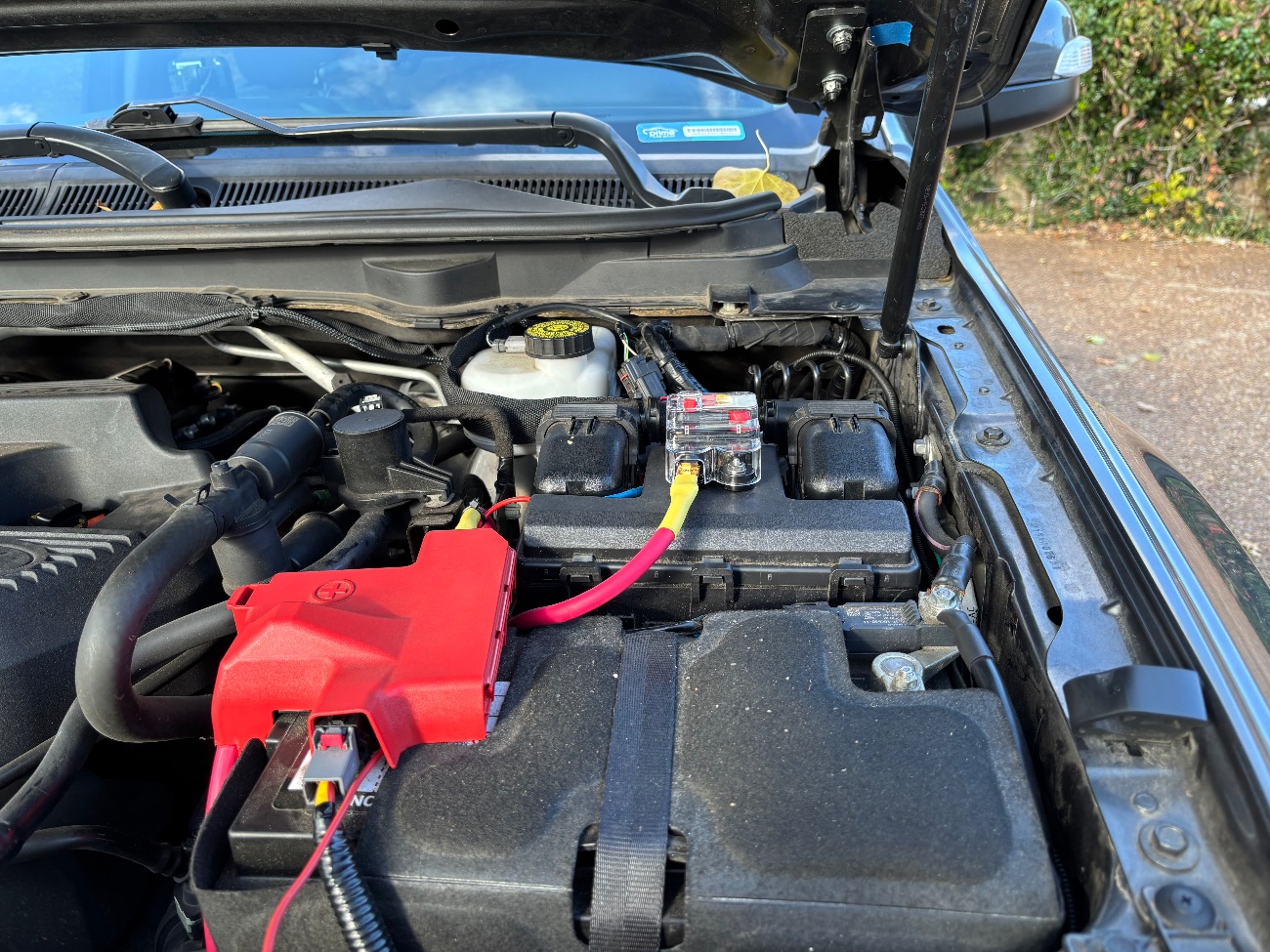

The 60 amp circuit breaker that came with control box was mounted to the top of the fuse box cover.

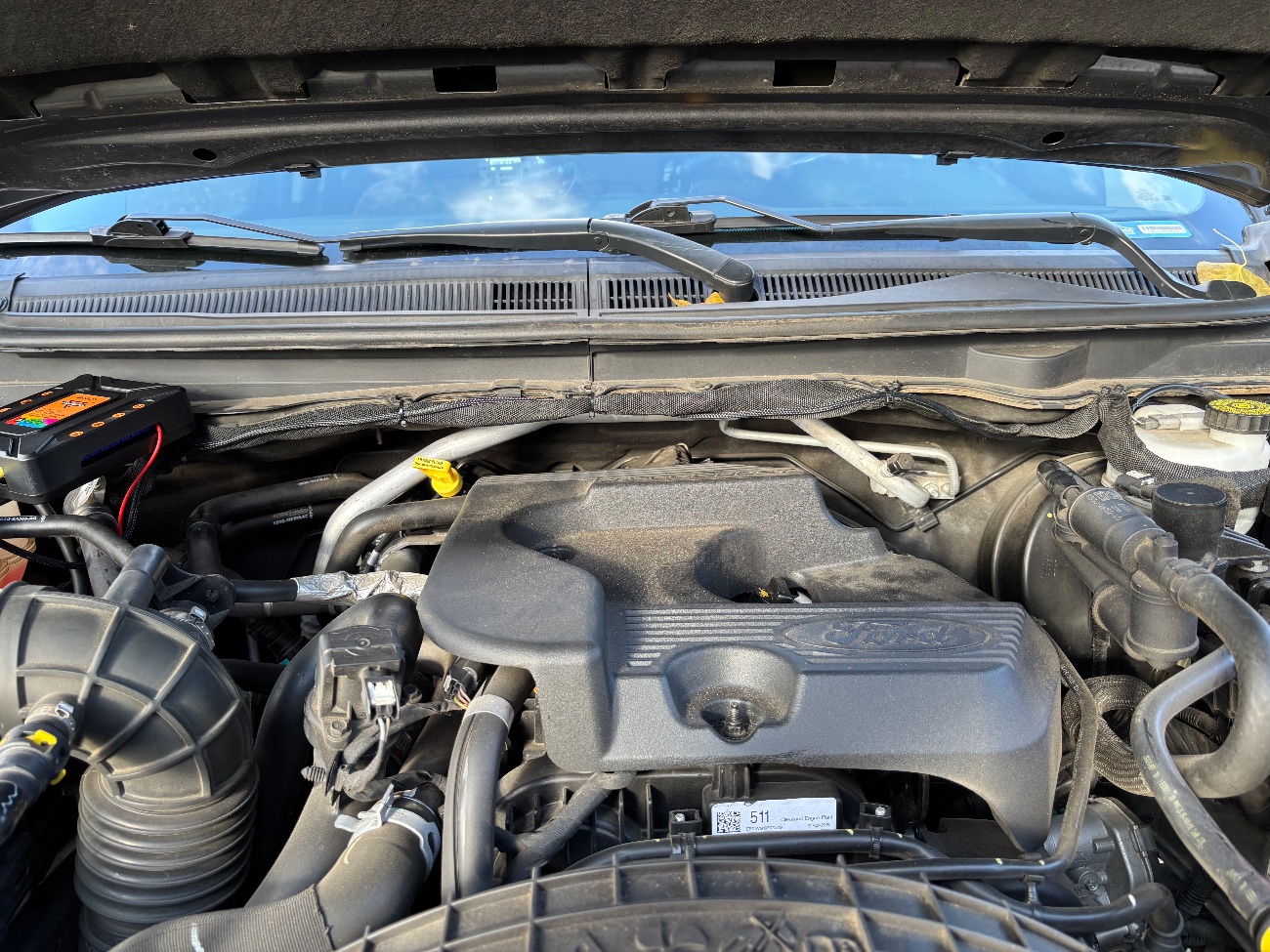

I custom built the power wire from the battery to the control box. It is run along the drip edge just below the hood seal in a wire loom.
There is a good grounding point right next the control box. At this point I connect everything up and tested. If I have a gripe with the Auxbeam control box kit is the power wires that come with it are substandard. It comes with an 8 gauge wires. I installed 4 gauge wire. Better safe than sorry. If you have a questions feel free to reach out. DM or post the question here.

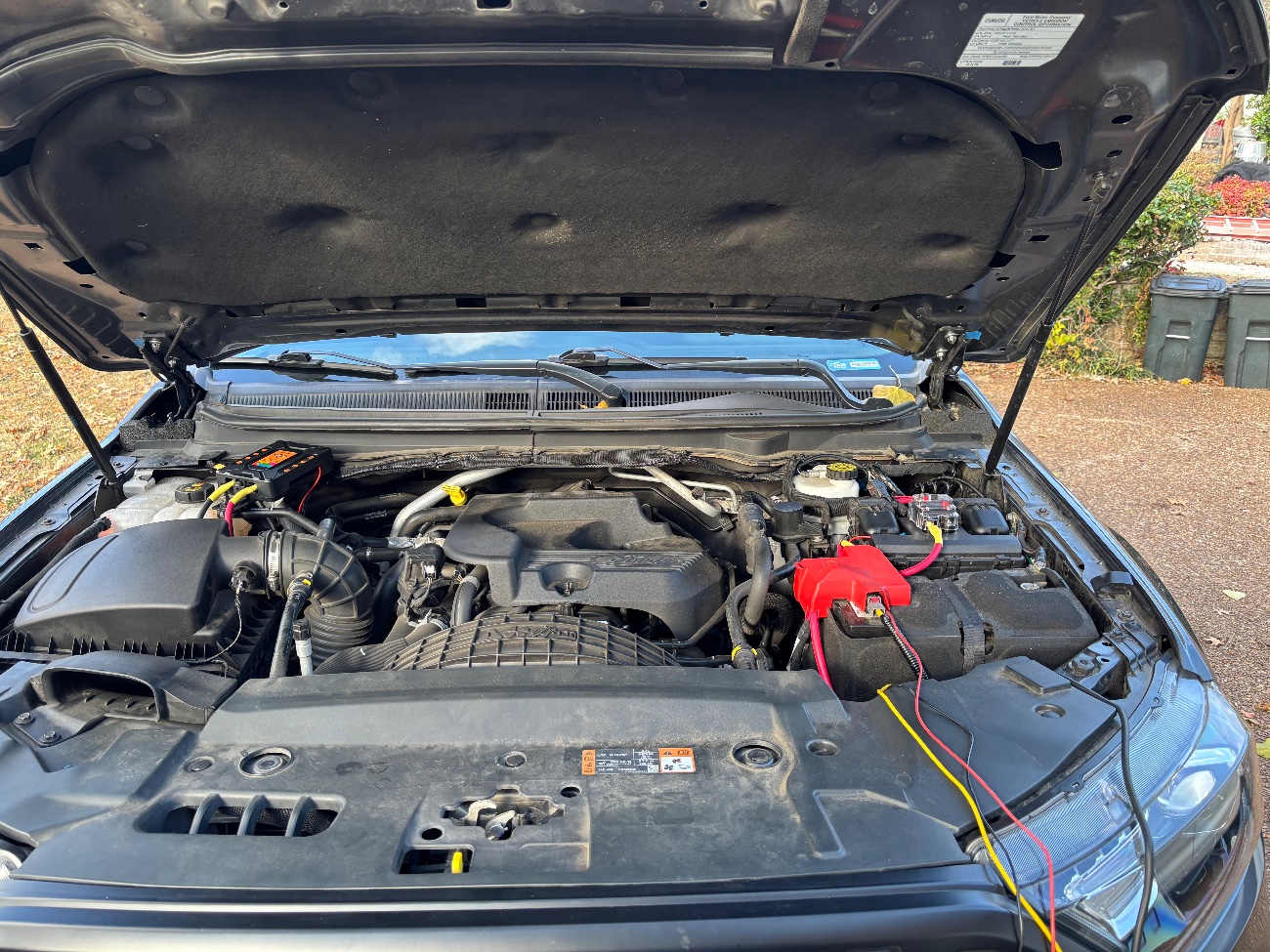

Completed install photo. Disregard the winch cutoff wires. I will deal with them later. 🤣

How in the world did you get a drill in there to make that hole?
I ran some wires through the FW through that rubber bulkhead bushing, but I had to take Yoga classes to contort myself to do so.
CMOS
It's under the hood and can't be seen obviously but.. a little heat shrink applied to the middle/unused section of that threaded rod would would pretty it up nicely.
🤣🤣🤣🤣my back wasn’t happy after doing it. Small drill and a stepper bit.
That is a great idea. I need an excuse to use my new heat gun.👍
I’ll send photos later this weekend.
Perfect!
Sometimes I come up with decent ideas... Sometimes 😂
