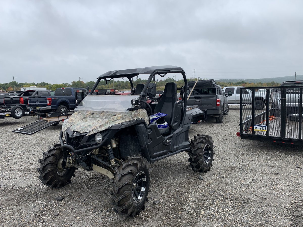

Out riding for 2nd weekend in a row...
48709
I'm just gonna cut grass and then go sell a couple hundred pizzas.
Do you deliver to Shamokin Pa?

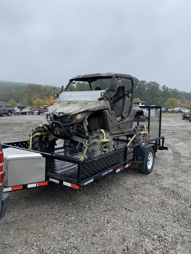

All loaded up... rain ended the day a little early.
48722
Whats the gear reduction on the portals?
