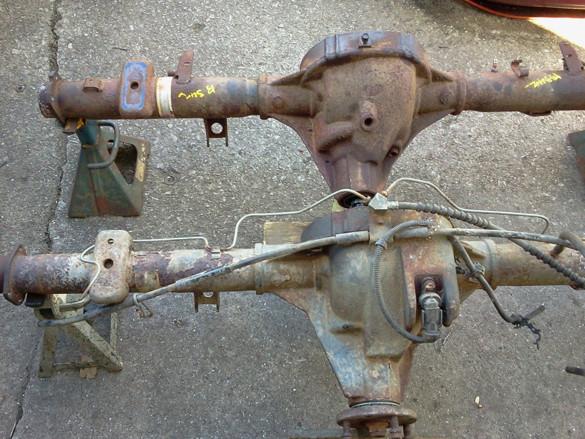

The axle tubes are bigger. So you’ll need new u-bolts. They should be changed anyway. And you will need the plate that goes on top of the leaf springs.
There are ABS sensors that are probably going to completely useless to you other than plugging the holes in the axle.
The flange on the front of the differential might be different, as in bigger.

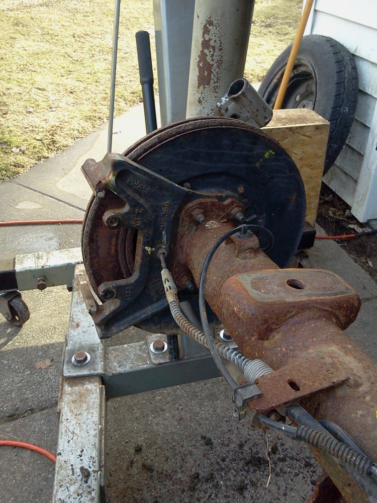

I just remembered. The ends of the parking brake cables are probably going to be different. So, you will need, at a minimum, the rear portions of the cables. You may need the front portion as well since the link may be different.

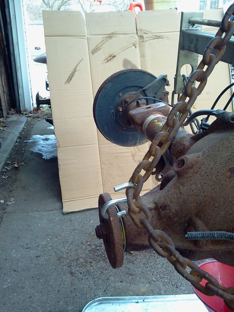

no provision for ring gear sensor on the 2011
the axles are 28 splines at the diff, they do not interchange with anything else.

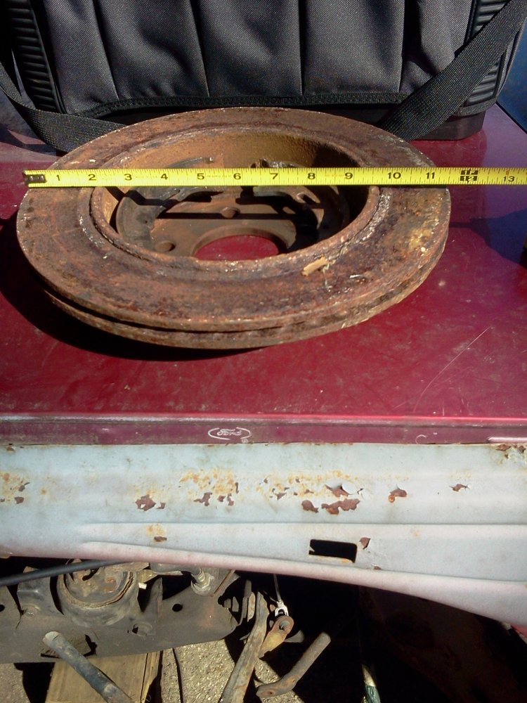

the disks have integrated drums for the parking brake
the disk mounting holes on the ends of the axle housing are unique.
the up side is large 11+ disks and the bigger 1.6" wheel bearing.
if you're going for a custom rear suspension the diff housing has the bung for the track bar pivot.
these are 2011 & 1994 axles.
