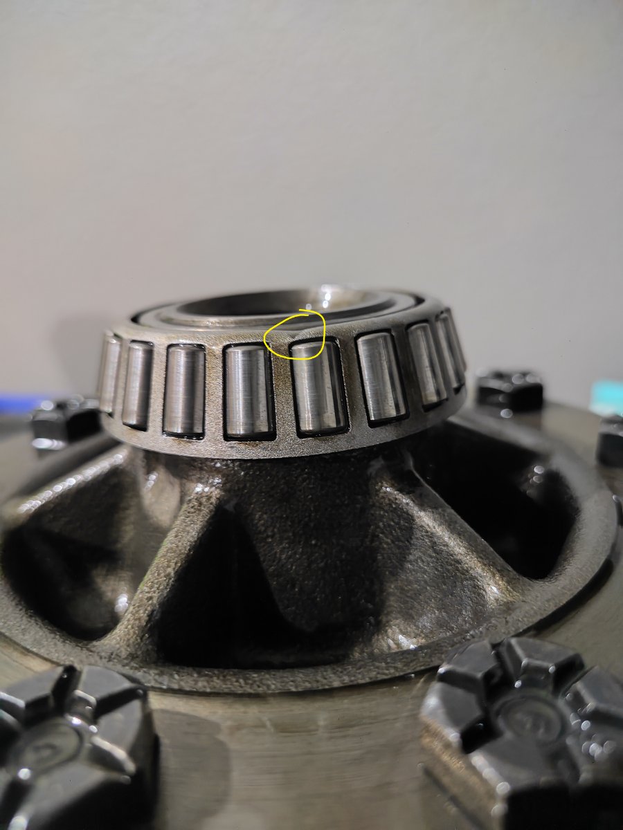

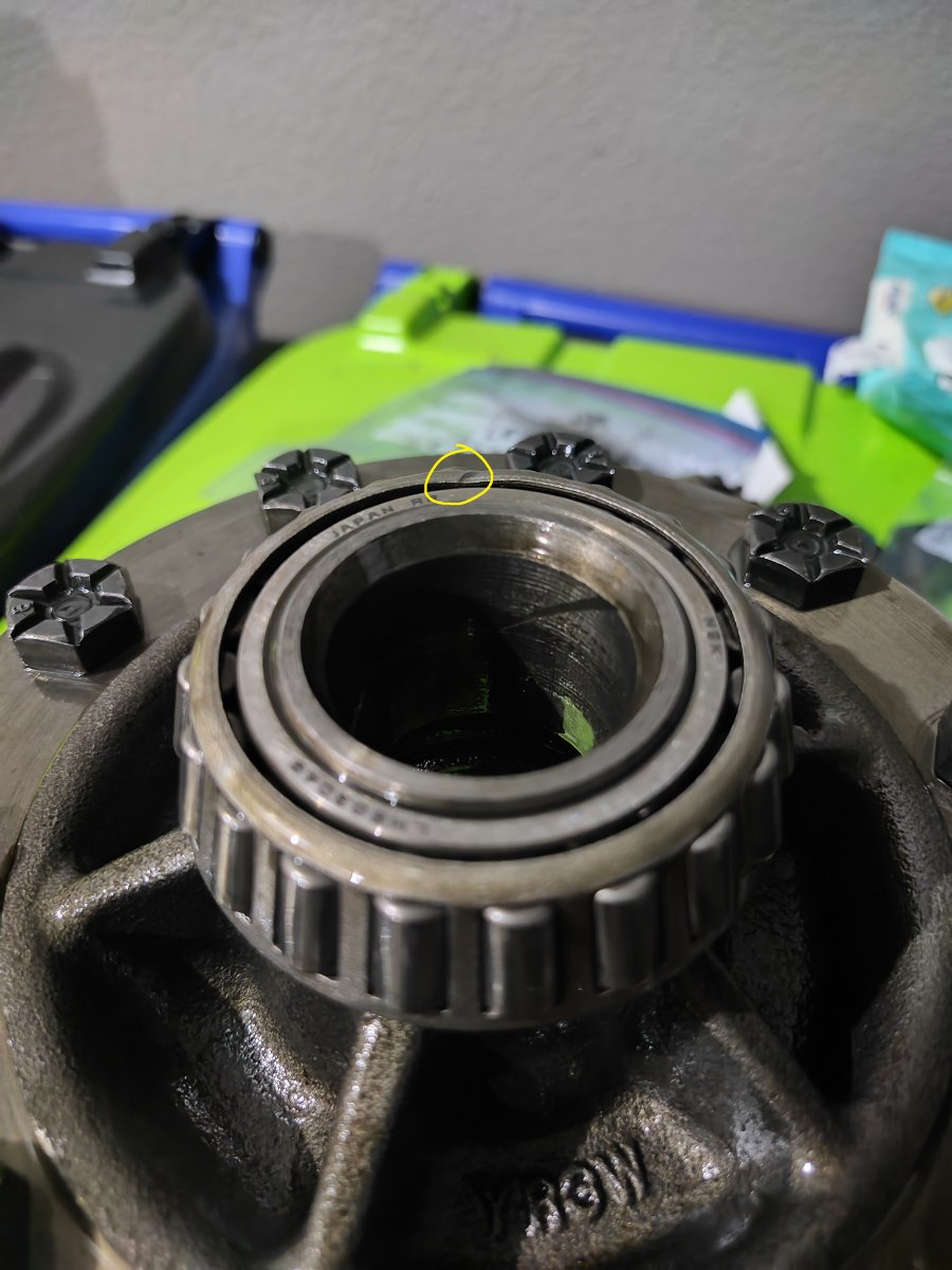

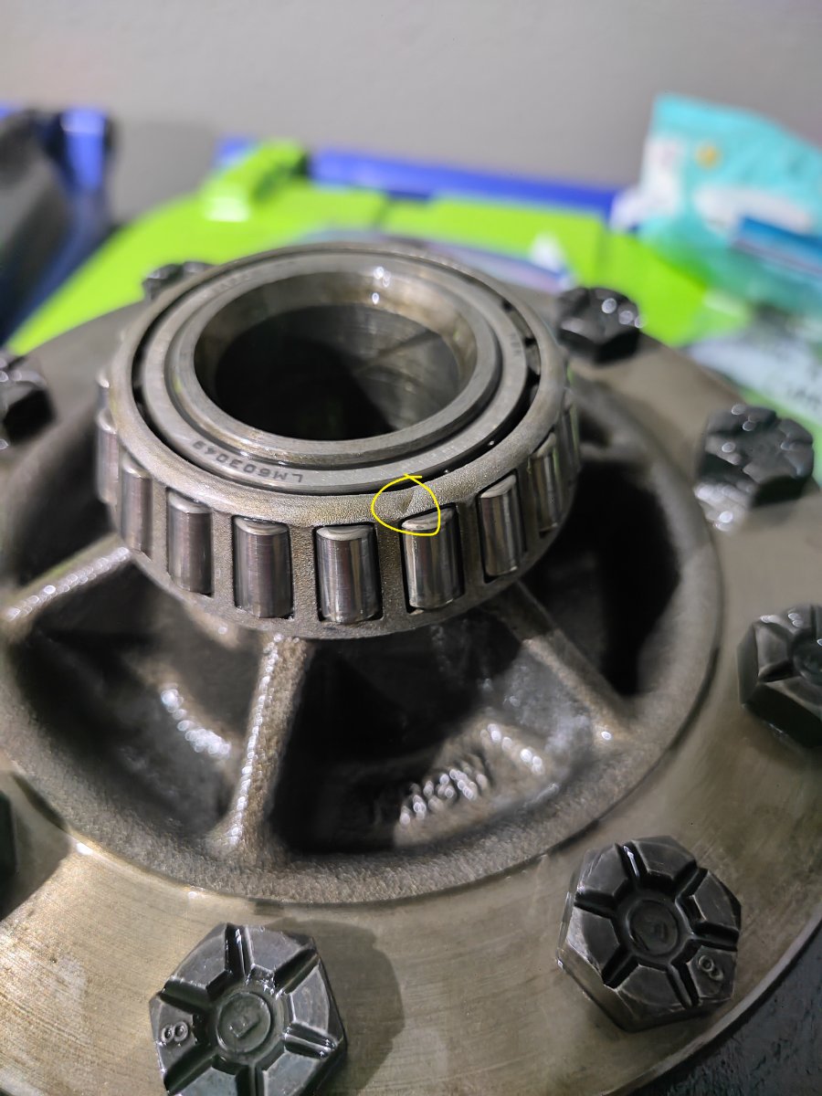

If the carrier is cracked, that definitely needs replaced as soon as possible. Since there are vaiances in carriers, expect to need a shim kit to get the back lash and tooth engagement set right again. Ford axles are a real pain in the butt to setup. So expect a lot of installing and removing the carrier. You might get lucky and the new carrier will take the old shim setup, but don't hold your breath
Since you don't have to mess with the pinion, that will male things easier. You just need to worry about the side to side distance in getting the tooth engagement right.
There is an article or two in the tech section that will show you what it should look like.
I did have some issues with ordering brake pads the first time when I first got the truck but maybe that was just amazon's fitment and/or my own ignorance at the time idk. But I haven't had any issues since. So it's not actually the carrier itself that is cracked, it's just the cage for one of the carrier bearings. It still seems functionally okay but I know that's no good. I almost wonder if that's from when it was installed and they just decided "oh well" and rolled with it. It was cheaper to order the bearing kit that comes with carrier and pinion bearings, a pinion seal, crush sleeve, gear paint, diff cover gasket, etc but I just plan to only replace the carrier bearings and use the pinion seal and diff cover gasket. I'll hold onto the pinion bearings and crush sleeve for the future when it comes to it.
The only shim I found was behind the right side spider gear so I'm hoping the replacement gears and bearings for the carrier match and kind of put everything back into alignment using that same shim or maybe I won't even need that shim with non-worn spider gears. I will check it carefully though and order some shims if I have to before closing it all up and running it.
Sounds like you have handle on it.
Thanks for your help Senor.

Agreed. It should be pretty obvious if it's dragging. Sounds like OP already has parts on the way. Might as well use them.
Yeah, it seemed functionally fine. I bet it's been there since installation. But I already got the bearing separator yesterday and the replacement bearings should be here in a couple of days so I'll just use the parts and get the practice in.

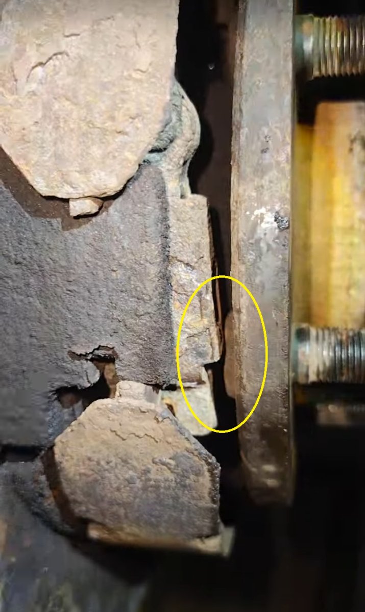

Well it turns out that "clunking" noise had nothing at all to do with all the slop in any of the gears. It was actually so easy to identify the noise that it's kind of embarrassing. It's the head of the studs in the wheel axle hitting the parking brake lever/actuator on the passenger side because the actual shoe itself came out of place. Not sure how or why it did yet but I guess I got so married to the idea that it was coming from inside the rear diff that I didn't even really try to isolate it further. And I only drove any of the gears manually by hand from the pinion itself or the driver side axle so it always kind of just sounded like it was from the middle of the rear. I threw in the new side gears, spider gears, and crosspin shaft to see the difference in slop and spun the gears from the passenger side axle this time and the source of the noise was so obvious immediately. If I push the parking brake shoe in, it gives the clearance between the parking brake lever thing and the stud heads and the clunking completely goes away. All the hardware for the parking brake shoes is rusted to hell though so I bought new shoes and am waiting for the hardware kit still. Backplate is good. Overall though, I'm still glad I bought the spider gear kit because the difference in slop inside the rear is night and day. Even with how worn the axle splines appear, there is noticeably less play with the axles and new side gears so I guess the inside of the old side gears were more worn than they appeared to be or the machining is different with these new side gears. And then inside the carrier with it all together, so much less slop between the spider and side gears. Huge difference. Very happy with it. Ready to get this damn thing back together though so I have a vehicle.

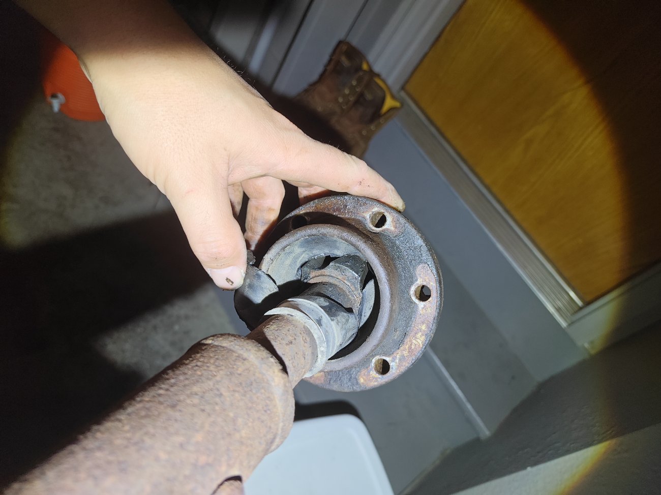

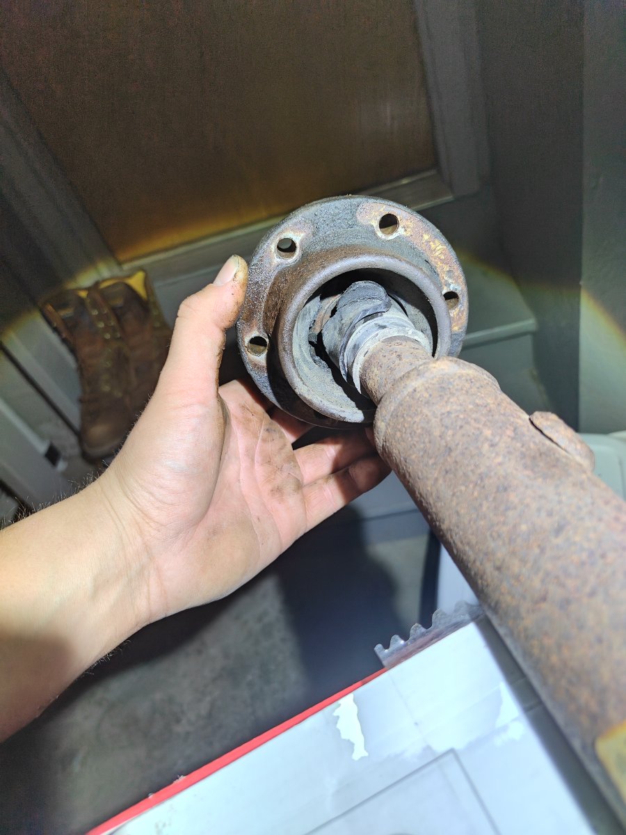

So it turns out the extreme clunking that developed which ended up being the parking brake hardware hitting the axle shaft stud heads is fixed but I still have the original tinny sounding clanking noise. I ended up jacking up the rear with front chocked and ran her in drive and the rear is dead silent and smooth. I was under the impression it was the same issue but just got worse. Nope, unrelated. Got it all on jack stands now and it's clear as day the CV joint for the front drive shaft. It's shot bad and rattling around. It's nice having a garage to work in now. Been living in apartments since 22' where they would complain about everything so I was kind of handcuffed. Just moved into a house last month over July 4th weekend. Moved everything alone with just my little rusty Ranger. Loaded her to the brim. What a breath of fresh air having a garage. Excited to get to start attacking some of these things. A lot of leaking seals I'm seeing...
Front drive shaft CV joint rattle
  • 2011 Ranger XLT Rear Diff Play
Pulled for now. Should get part tomorrow.

Just to finish the story, I got the CV joint repair kit which worked out great. It was much cheaper than replacing the entire shaft that came with a new CV joint and u-joint and the job was easy with the right tools which I bought to save time and I know I'll 100% use again. I also replaced the u-joint while I had it out. It's been installed for several days now and that clunking is completely gone. It's so quiet driving now with just a little bit of exhaust noise. The piece of mind. Ahhhhhhh. I'm so happy with the results. So, two totally unrelated clunks have been fixed and I learned a lot in the process about the rear end as well. I also have an actual working parking brake now on top of a much improved tool set as part of the process. I decided to cancel the return for the rear end bearing kit as well as some shims I bought just in case. I'll keep them just cause. Up next is the intermittent 4x4 before winter hits and then probably the other leaky seals, nasty looking CV joints, etc. Oh, and turns out the front drive shaft CV joint was also responsible for like 90% of the squeaking I had. Thanks for all the info and help everyone. Much appreciated.
