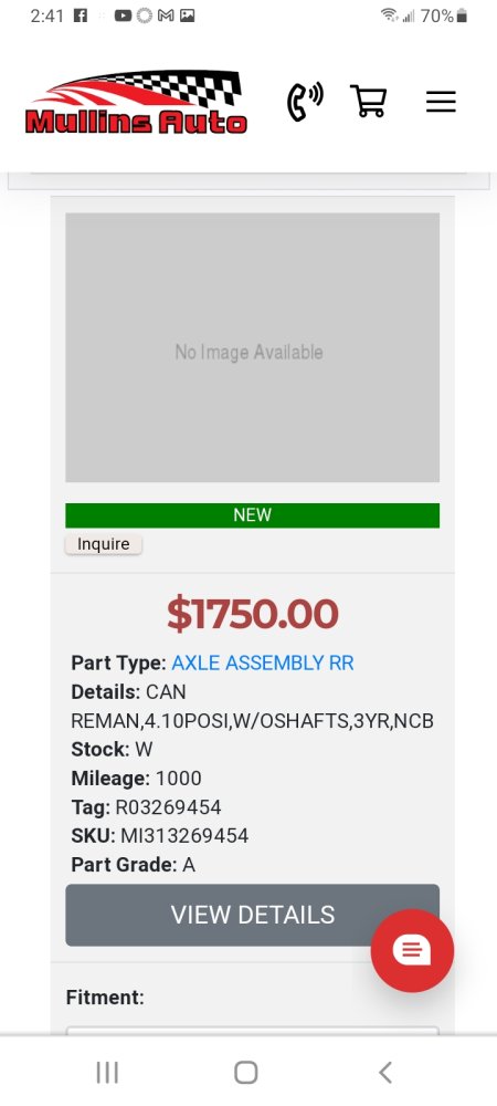

2010 rear end
I could not believe that the rear end for my 2010 Ranger. I know it's special because 2010-2011 Ranger had rear disc. The research I did they are hard to find most are $700-$800. Wow I love my Ranger but what to do. I need my Ranger to go get a rear end for it.

The one you posted originally is a rebuilt. So yes its "used" technically but all (or most) the guts should be new.
The webaite i posted is basically a search engine for junkyards and that would be "used" all the way through. But being a 2010 it shouldnt be to hard to find a decent somewhat low mileage rear for alot less money.
