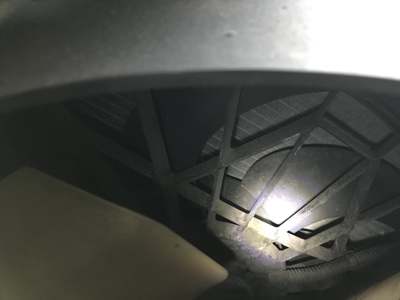

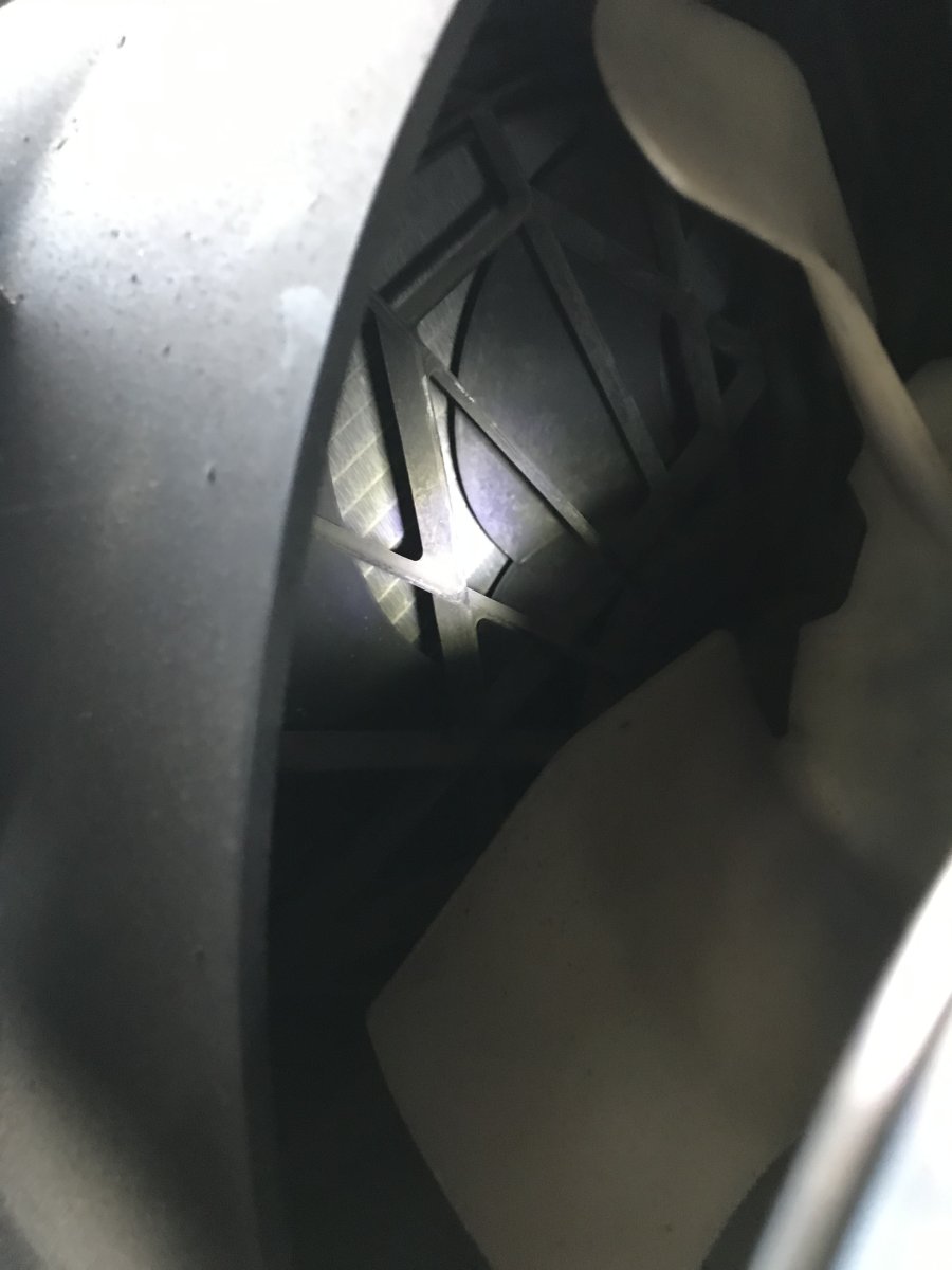

I see an electric fan in there, does it turn the correct direction?
I'm embarrassed to admit that I'm not sure which direction it should turn. I'd imagine counter-clockwise from the perspective of the pictures?
Weird. :icon_confused: Also with the shape of the blades they'd have to rotating in opposite directions too. Right?
Yeah the fan is driven by the backside (smooth) of the serpentine belt. The fan spins CCW while the crank pulley spins CW.

I went out and took a good look at my e-fan. Looking at the pitch of the blades it rotates CW from the perspective of facing the grill. Opposite to the rotation of the clutch fan.
The blades rotation doesnt matter as long as its pulling air thru the rad. I wonder if the electric is not working and blocking flow?
Can you disconnect the electric connection and using some jumper cable hook directly to the battery? And jumper meaning some small gauge wire with the correct ends to fit the connectors.
Is the e-fan operating as it should be?
If not, it's just serving to block the air flow that the clutch fan is trying to pull.
