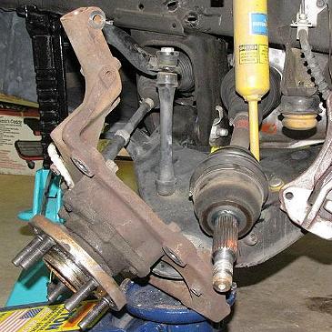

Here's the official walkthrough. I'm assuming the 9'8 ranger has the same knuckle as the '07?
As I understand it the lockable hubs are weaker then the hubs on a live axle ranger. This may be a problem down the road for you.

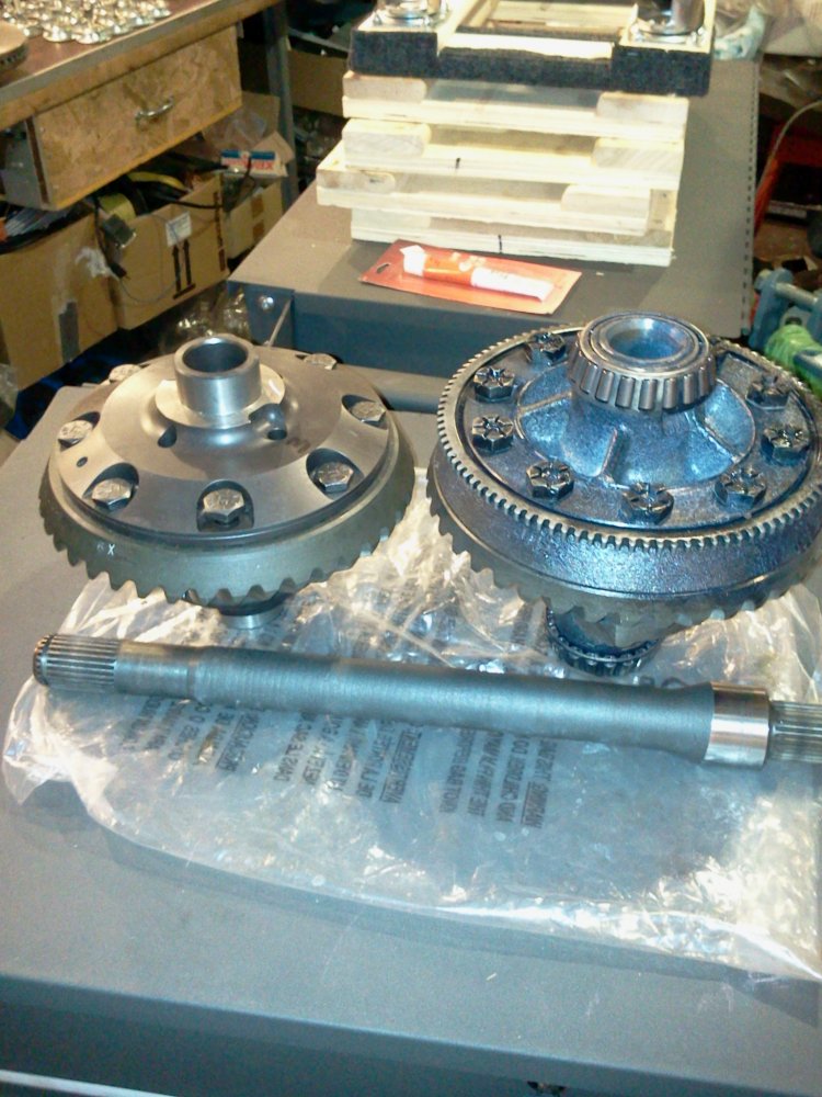

the front diff in 98+ SLA rangers is 27 splines.
here is a size comparison between a 7.5 rear carrier and a front D35-SLA.
the rear is about 7.5" wide, the front is less than 6.5" wide, bearing to bearing.
note the front is only 8 ring gear bolts.
Thank you very much!
