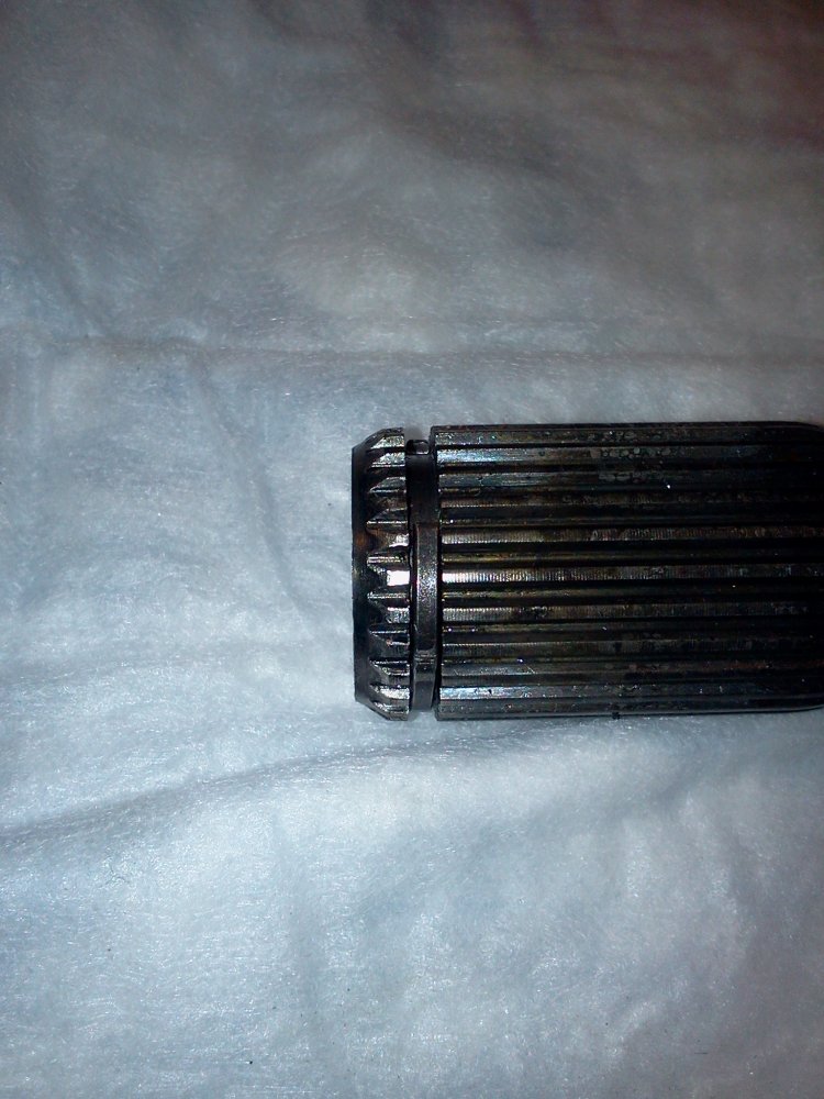

check this thread.
the ring is compressed to slide into the side gear, then expands on the other side of the gear.
to install or remove the outer gear needs a slight taper to compress the ring.
a straight edge (like a rear axle shaft) will just crash into the ring but not compress it.
think of installing pistons, if you don't compress the rings the piston is "locked out" of the cylinder.
