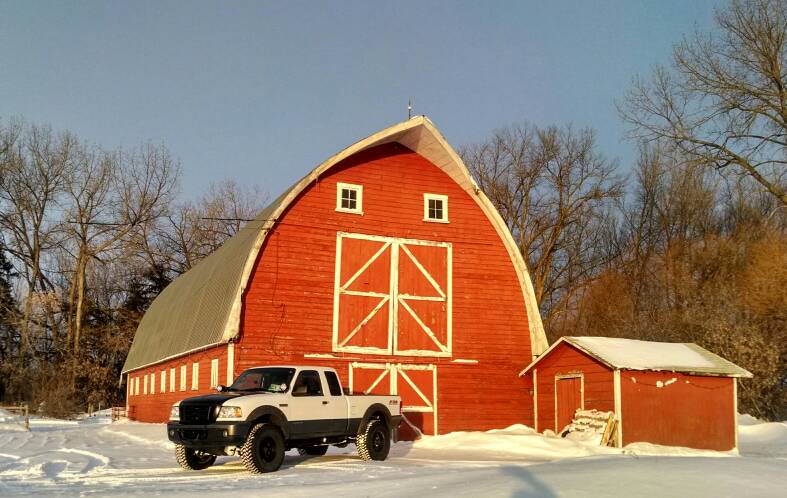

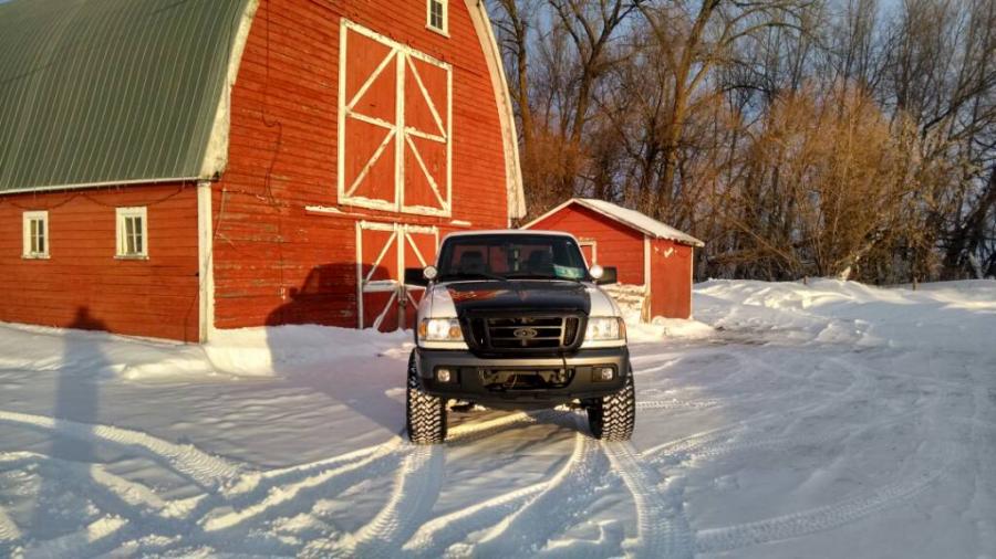

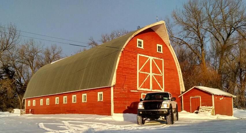

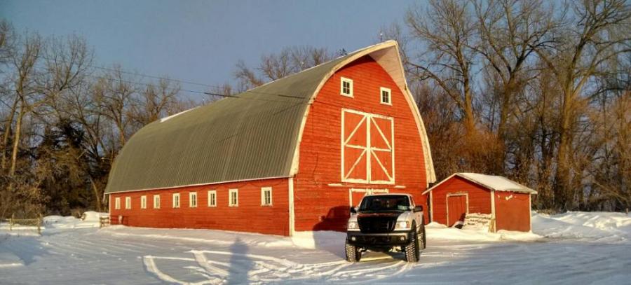

Alright. So I took a few. pics in front of my brothers barn just for the hell of it.
Noticed something. Lets see if you guys can catch it.
Sent from my XT1058 using Tapatalk
You were supposed to notice the driver side you're out of alignment lol. Something's definitely bent. Time to upgrade

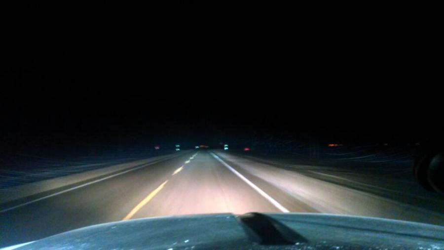

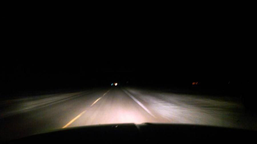

Here's some night pics of the hood lights.
High beam + fogs vs low beam + fogs + hood lights.
As always with pictures it is a bigger difference in person

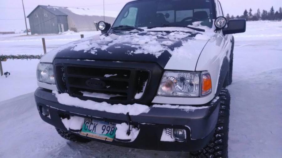

Ah it doesnt look like a manitoba plate from that distance. I see it now that you mention the alignment.
Haha yeah I busted through a few 3' snowdrifts and the zip ties holding the plate on didn't like it lol. So I got it in the windshield now. Will leave it there till a cop pulls me over lol.
Driver side tire is out of camber again something has to be bent I'm guessing lower control arm. It took a hard hit on this jump.

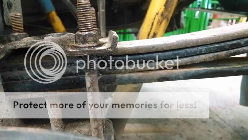

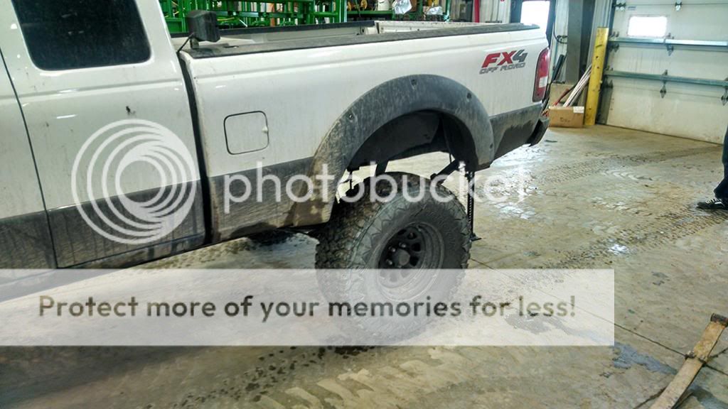

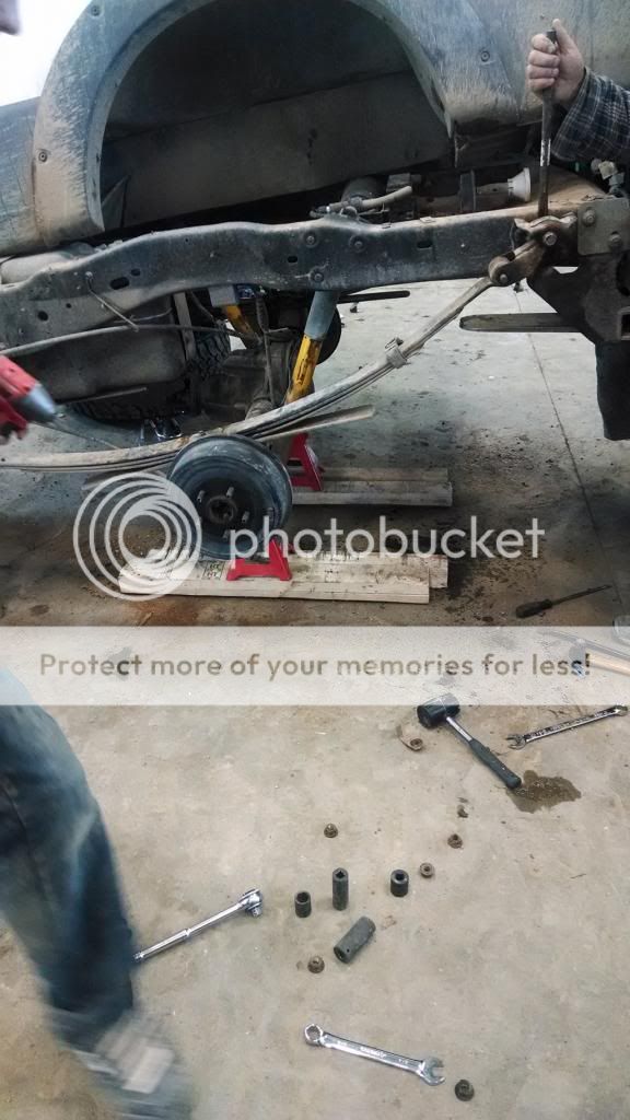

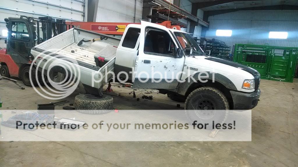

small update. had a cracked leaf spring, so today's task was replacing those.
bought a set of used 08 ranger springs. wanted chevy's but time and money was in charge so ranger leafs it was.

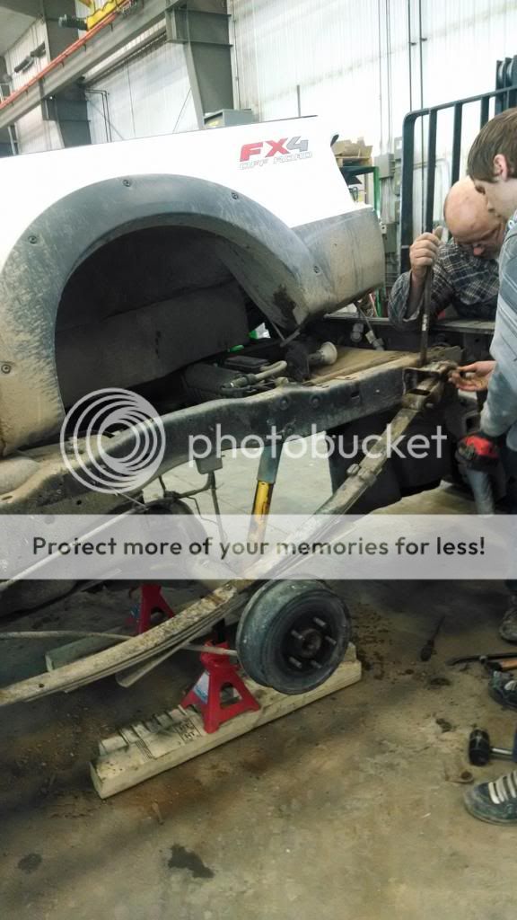

passenger side was a breeze. took maybe 20 minutes start to finish. driver side, well that was a different story. both the bolts on the shackle were stuuuuuck. anded up grinding the one on the leaf off, and luckily found another bolt that fit perfect. ended up grinding the rivets off the shackle hanger and using bolts in there to. just becuase.
gained about 1" of lift from the new, non sagging springs. and rides so much better. can't wait till i can do the chevy swap.

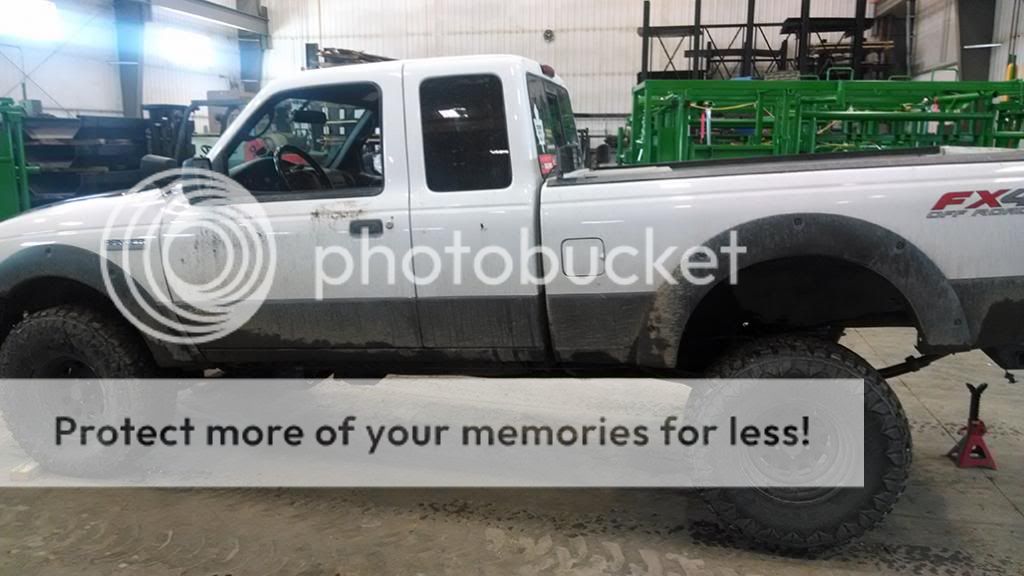

few pics for fun.

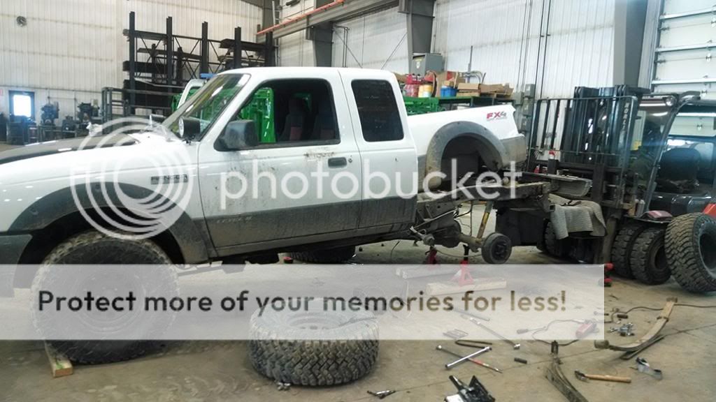

ended up having to take the bed off to get leverage. finally got it.
NO CRACK!!!! :D

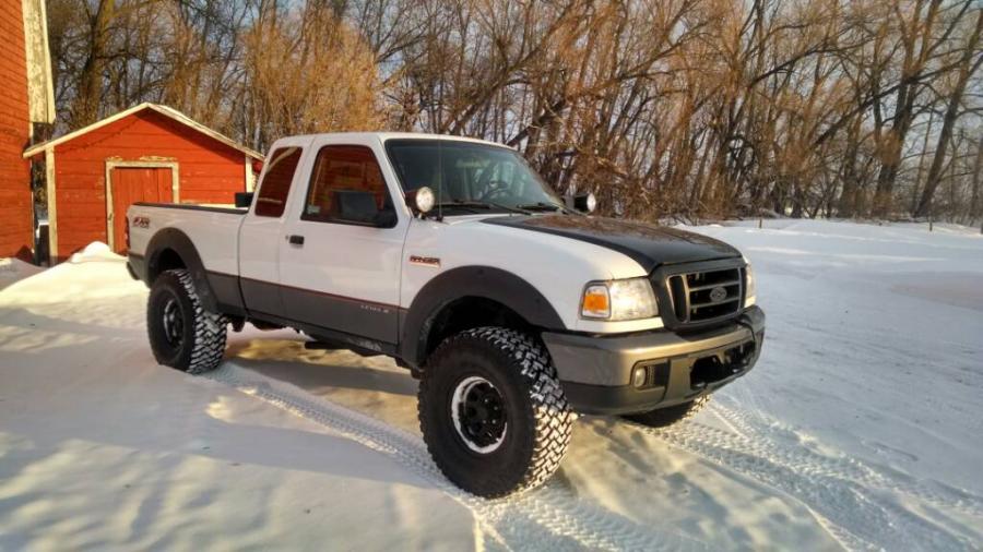

Tossed a new battery in the ranger. Old one wasn't holding a charge anymore. I'd have to boost it if I let it sit more than 3 days.
The new leafs I put on a while ago are still doing good. Seller said he took them off due to sagging. And they gave me 3/4" of lift lol. Mine were baaaaad.
