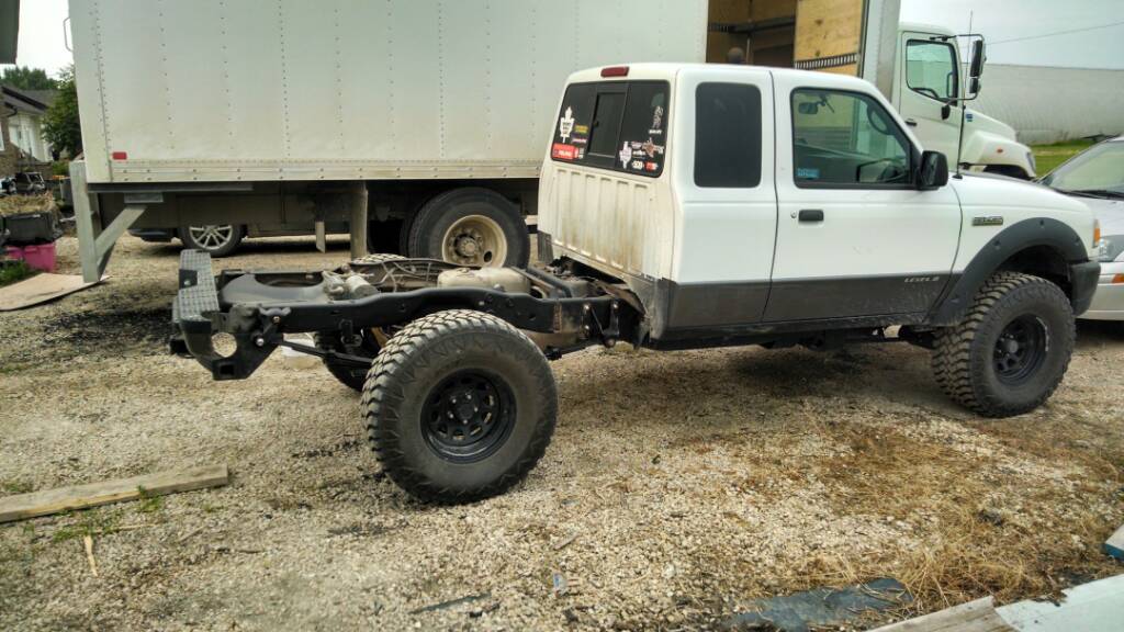

Frame clean up.
Nap time while that dries.
Meow.
Hangers moved and bolted on.
Destroyed a grade 8 bolt. Oops.
Leafs on. Yay!
Tires back on. Sitting on its own weight.
Took it for a spin, let it all settle, and measured the added height.
With removing the stock 2" block, I still gained 2.5". Probably end up being 3" with the bed back on. As these ones don't sag as much making ride height taller.
Rides nice, still have to test droop for new shocks.
Bed back on. Rides so nice with all the stuff in the bed.
Need to test then articulation now. Did a small test at home, but its got so much more now.
Yeah now your shocks are gonna limit your travel. Time for longer shocks!
Yep. Going to grab some 12" travel shocks. About 18 compressed and 30 extended. Should work good.
