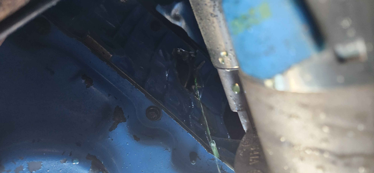

Well, I joked about how it was either going to be something really dumb that caused it, or something extremely insane
It was the latter
Basically, cyl 3 exploded, I'm not sure why yet. Thinking a valve wanted a career change. The chunks knocked the oil pump loose, jammed the crank and broke the bolts holding the end cap for cyl 6 off letting it do whatever it wants. Which was to try and go out the oil pan
The bottom half of the oil pan with all the piston-y goodness
Pictures of the con rod and chamber of cyl 3, darn phone wouldn't focus enough to see the head. Which is done
A new drain hole for the oil and the crank side of cyl 6
Cyl6 saying hello to the world again
