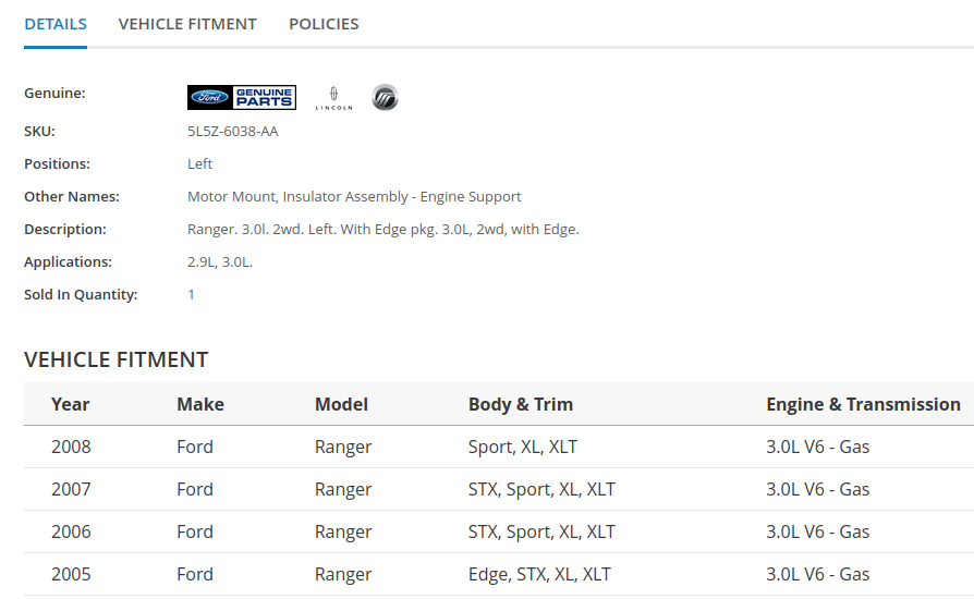

Left 5L5Z-6038-AA
Right 5L5Z-6038-AB
Can you guys suggest any aftermarket brand, I've had no luck finding anything for this Year/EDGE trim model.

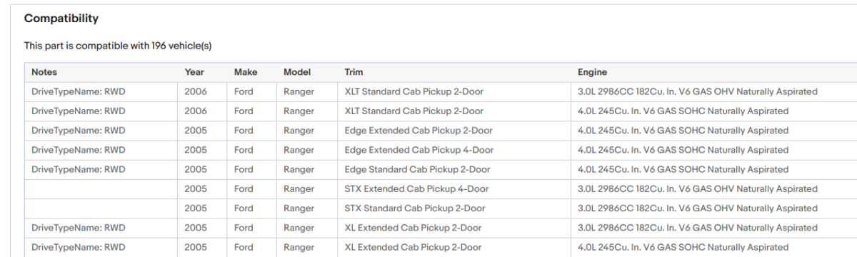

I punched in A2853 in a google search and Amazon came up. They wanted more info and I said that it was a 2005 STX. They claimed it fit, and then I went down in their description and some years this mount fit both sides, some years it only fit one side, some Mazda's it fit both sides. I do not know if you can tell from the pictures if it would fit or not.
Thanks
In the compatibility list the EDGE 3.0L model isn't listed for either of those mounts.
The mounts for the 3.0L EDGE are so odd they would probably only cover, 2002-2006, when this trim package was made. But I'm only guessing here. The common mounts you find covering 83-2011 are for other trim packages, mostly Rangers with front coil springs.

What is that screenshot you attached saying? Whatever part it is referring to fits all those different models, including the STX models?

The attachment doesn't show an EDGE in the Trim Column, and a 3.0L in the Engine Column.
What I commonly find with the aftermarket stuff.

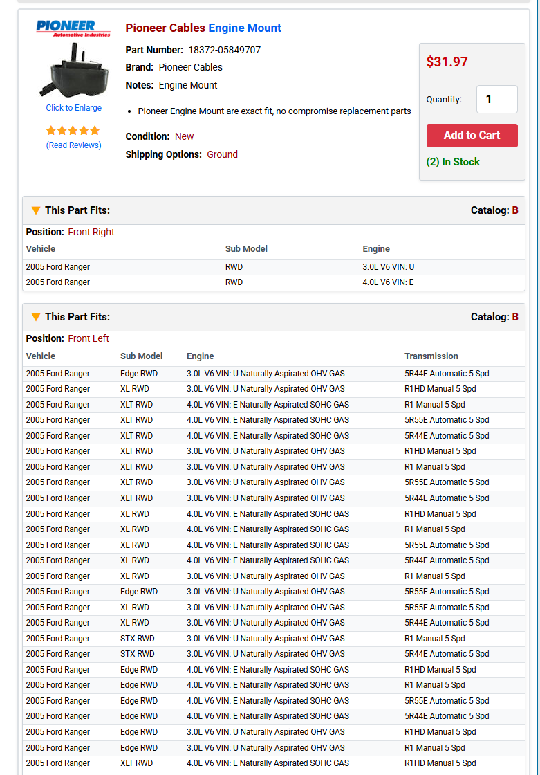

The parts folks at Ford didn't give 4x4 mounts as an option, so I need to line up the year and the engine with aftermarket mounts. Or reuse the old mounts I have...disappointing.
You're just SOL if you want OEM Ranger 3.0L motor mounts for a 2005-2008 Ranger.

Pull up the numbers I posted, and you'll see they also show fitment on '05 3.0L Edge, specifically. I don't know what the difference is (hydraulic vs. non?), but I would be looking at pictures to see if the 4x4 mounts are actually different than mine.
I know they list a 2005 Edge 3.0L but the online parts places kick back a message (from real people) with my VIN stating it's the wrong part number. The 4x4 mounts are at a slightly different angle where they contact the frame.

I am in this friggin boat now. Since I'm dropping a remanufactured Jasper engine into my truck after 256k miles, I've been looking for a few days no for a front left engine mount for my 2005 ranger edge 3.0 2WD with torsion bars... its been a nightmare.
AutoZone has the Duralast listed as in stock for only the passenger side, and I can't seem to find the driver side(left) anywhere. Can someone please tell me if the aftermarket has made that passenger side installable across the board
to be mounted for both sides now? On partsgeek.com the sales associate put two passenger side mounts in my cart when I asked for assistance in building a mounting kit (both front mounts and transmission mounting bracket).
