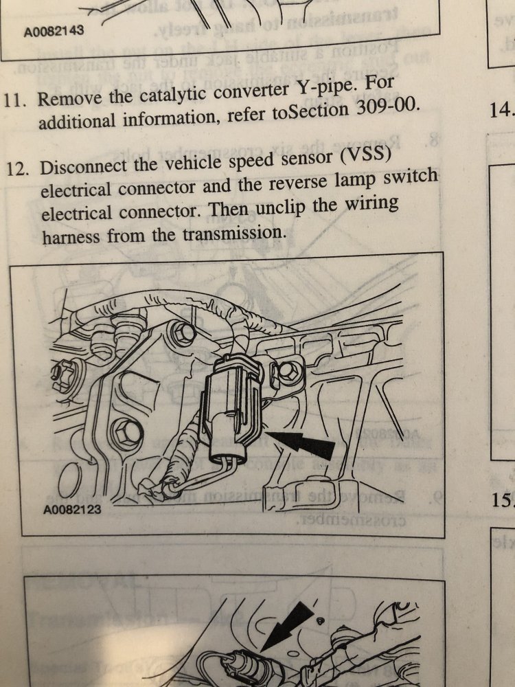

I believe this not the case because my speedometer still worked fine with the rear WSS on the rear differential unplugged. I think there is a VSS on the transmission but am searching my workshop manual to confirm
Update/Edit: I attached a picture of the VSS on the transmission

As far as I knew 98-2011 used a single sensor for the VSS and ABS? :dunno:
Of course I've only dealt with autos so maybe the manual trans still uses a sensor on the trans? Doesn't make much sense for them to do that but who knows.
Its a 4WD
In 2001 Ford switch to from VSS to OSS speed sensors located on transmission, on 4WDs the speed sensor WAS located on the transfer case for correct speed in 4LOW
So with OSS on the transmission the Computer must correct for speed when in 4LOW
