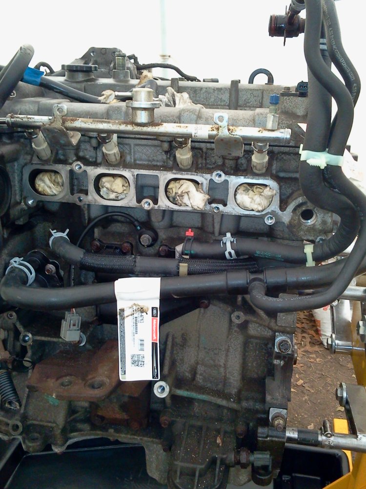

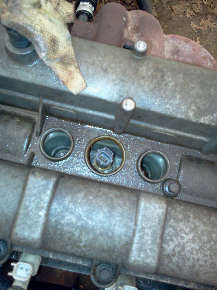

prepping a 2002 to put in my 2005. swapping the external parts to match. I'm leaving the 2002 aluminum valve cover since it isn't leaking. fuel rail will need swapped, intake vent by the oil cap is a miss-match to the 2005 hose.

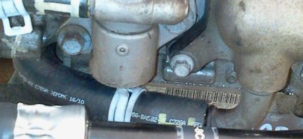

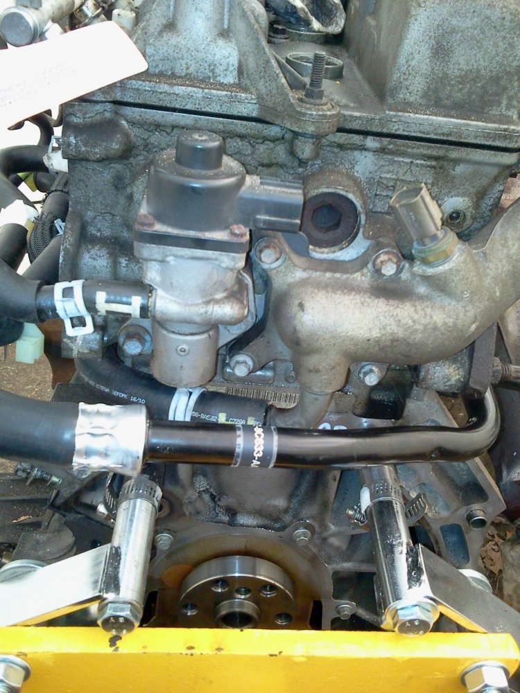

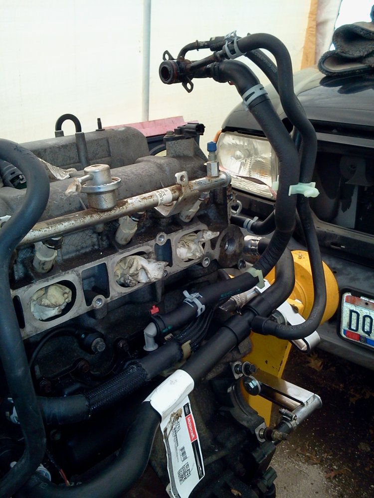

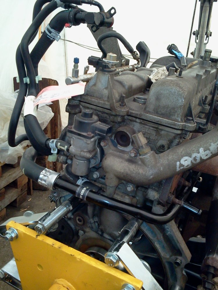

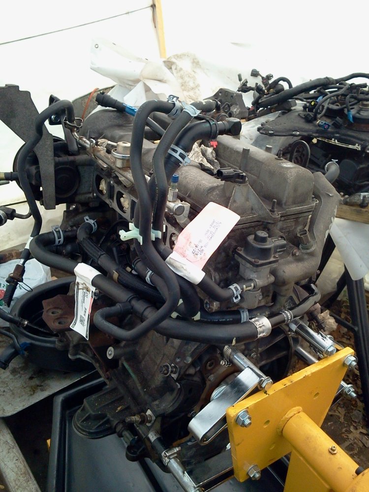

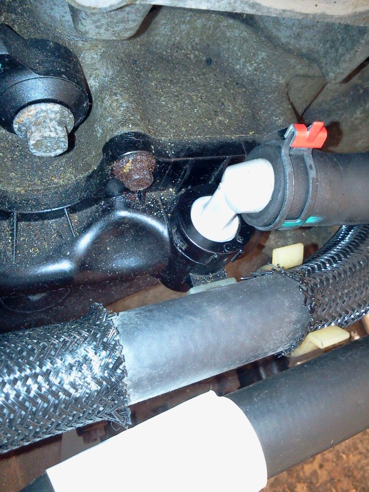

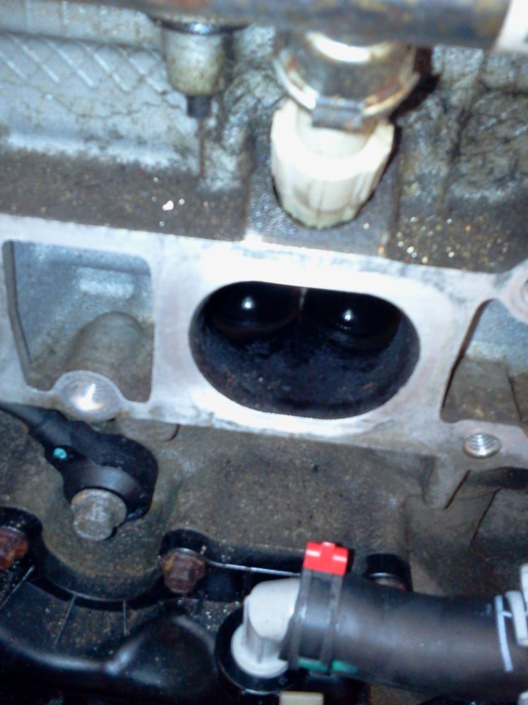

here are the dreaded rear hoses. by the time 2005 rolled around a small adapter was used to connect the 3 hoses to the rear of the intake manifold, 2 screws remove it.
the large hose is from the PCV, the 2 smaller are coolant to keep the adapter warm so vapors don't condense.

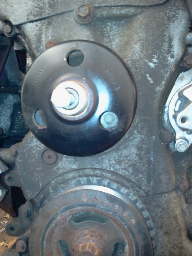

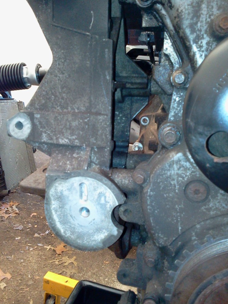

there is a bolt hidden behind the pulley that secures the timing cover. the thread inside the pulley shaft is 3/8 coarse.

the EGR solenoid also has coolant, that's the same line going to the manifold port adapter.

retaining cap for PCV, tough little snap. I bought 3 new ones from Ford last week.

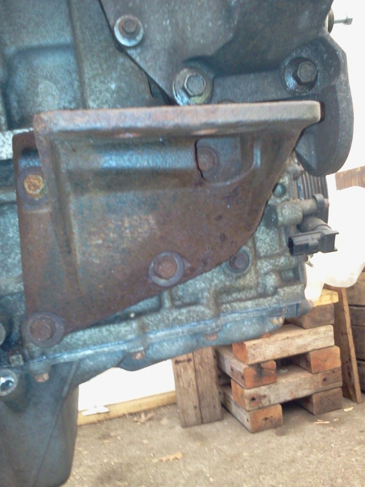

motor mounts, hidden bolt on pass side.
