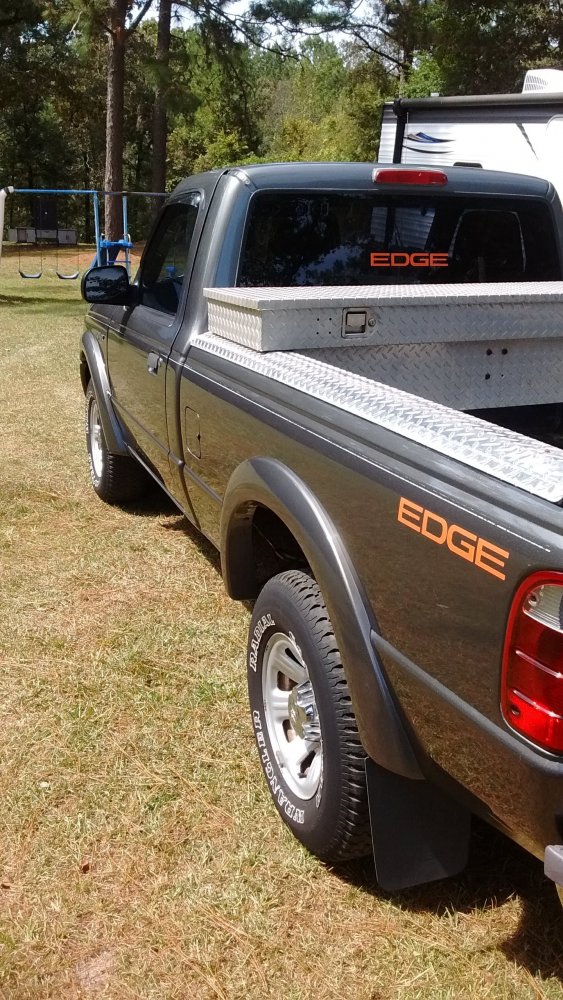

Hi, I am new to the forum. I have a 2004 Ford Ranger Edge 2wd with the 3.0l v6 with 144,000 miles and auto trans. I love this truck. I've owned this truck for 4 years and I have maintained it well. I wouldn't be afraid to take this truck anywhere until now. What I am about to describe didn't happen suddenly. It has just got to the point where I am scared to drive it. The truck cranks right up runs and shifts fine and it will take you anywhere. But now when you drive into town (for example) and you get to your destination and turn the truck off. When you get ready to get back into the truck it will turn over but not crank back up. But if you let the truck set for 30-45 minutes it will crank right up. I hear the fuel pump cut on, there are no lights on the dash, hooked up my scanner and there are no codes. I checked all fuses inside and out and they were all fine. It started this about a year ago. But in the beginning you didn't have to let it set but for a few seconds and it would start right up, and it just did it occasionally. Now it has became a constant thing. On a total different issue about six months ago I changed the coil pack, new plugs, and plug wires because a miss started while driving between 45-50 mph. I replaced all parts with all genuine motorcraft parts.
