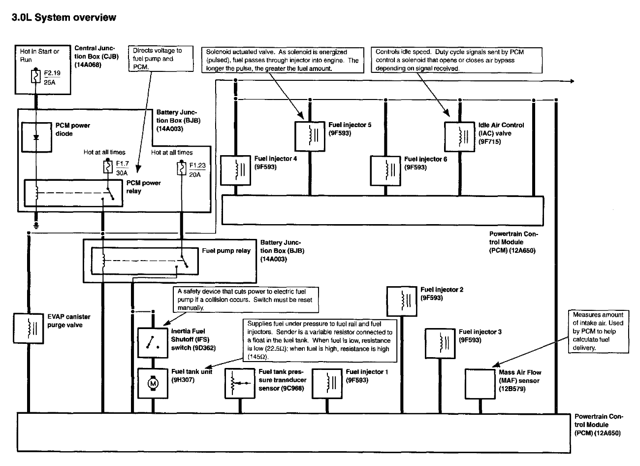

Here is a diagram with more important fuses to check. F2 fuses are in the cab. F1 fuses are under the hood in that fuse box.
