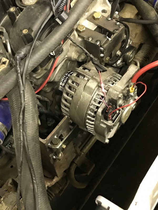

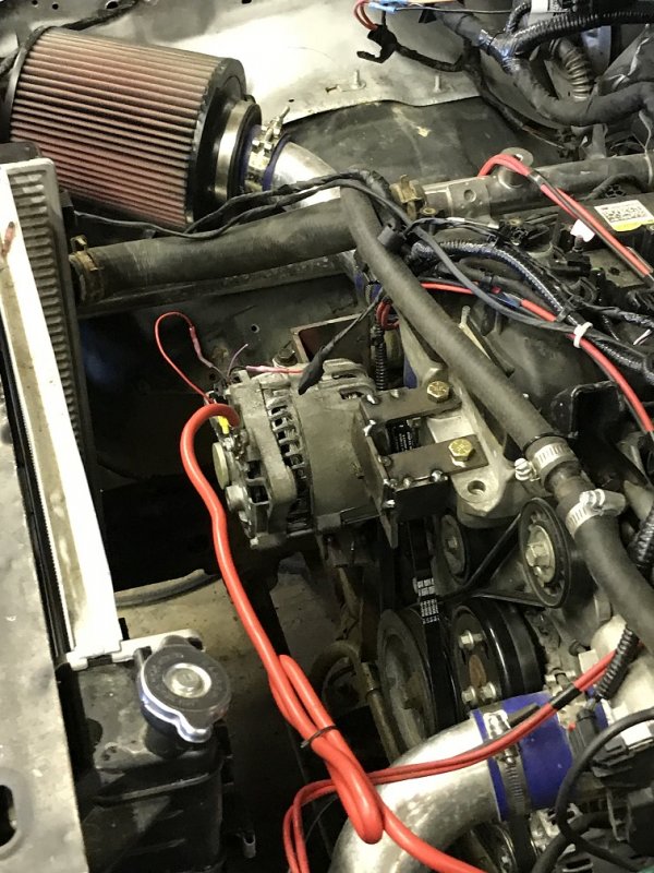

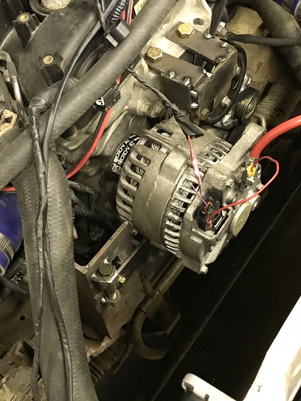

First off, the alternator. The little 70 amp 1 wire denso alternator I used went out within about 5-6 months and I needed something reliable. My idea was to but the stock duratec alternator back on, but there wasn't really room on either side of the motor. So I decided to make a bracket in front of the motor and run it backwards. It works just fine and puts out 14.5 volts at idle so I'm happy with that. Might look a bit sketchy but this is how ive been running it for months.
View attachment 29067View attachment 29068

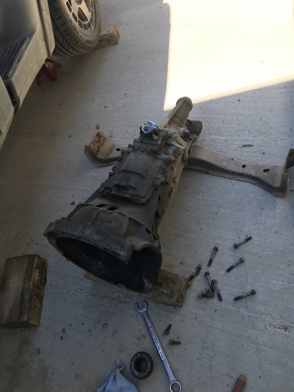

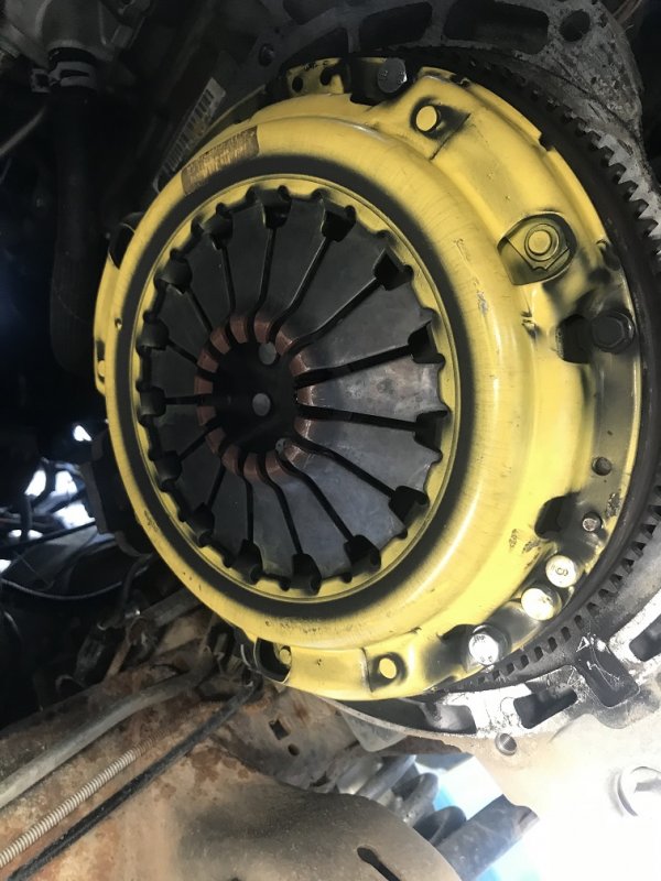

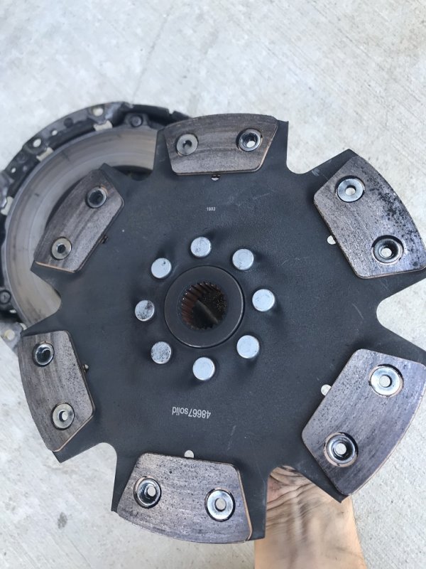

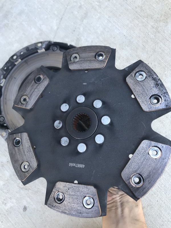

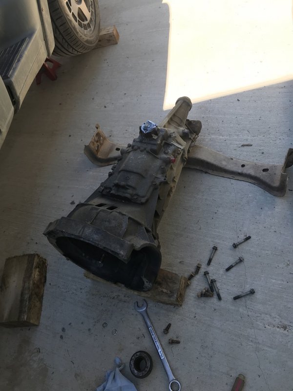

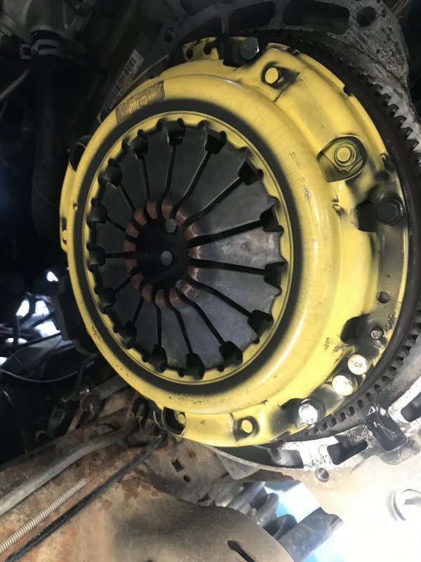

Aside from the alternator I haven't had any engine related issues. One issue I mentioned in this thread a few times before was just fixed today. The "clutch disengagement" issue, basically sometimes made a hard wall between gears for a split second randomly. No clue what caused this 100%, but when I pulled the trans today I found that the little snap ring on the input shaft that holds the throwout bearing in place wasn't sitting in its groove. That as well as the shims I put behind the slave cylinder were removed. I used to run a ClutchXperts stage 4 ranger clutch which was unsprung and a 6 puck disc. I changed out to their stage 2 organic sprung disc today and it shifts like brand new now. If you do this swap I would recommend at the very least running a ClutchXperts stage 2 clutch as its rated for just under 300 hp and torque. Its also a very affordable clutch in my opinion.
View attachment 29069View attachment 29070View attachment 29072
Aside from those 2 issues being fixed I recently ran into another odd issue. Randomly out of no where My truck stalled out with half a tank of gas left a few days ago. pulled a fuel line off and it didn't have fuel pressure. Added 1 gallon of gas and it started right up. I'm guessing something in the fuel sending unit/pump fell apart and is causing it to not make pressure when at or under half a tank. That or the pump itself is just slowly starting to fail. I ordered a whole new sending unit and will be doing that later on this week. That about all I've got to add to this thread since my initial post almost a year ago. Hope every one has a happy 4th of July! Also I will be updating my Bradley GT build thread some time soon.
