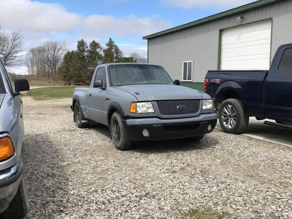

@02 EB swapped ranger, did you ever say what transmission and rear gears you're using.
And no heat, but what about a/c?
No AC, I am however running an aftermarket heater core in the cab. Trans is a stock 2002+ 2.3 ranger trans. 3.73 rear gears and a 7.5 open diff.
