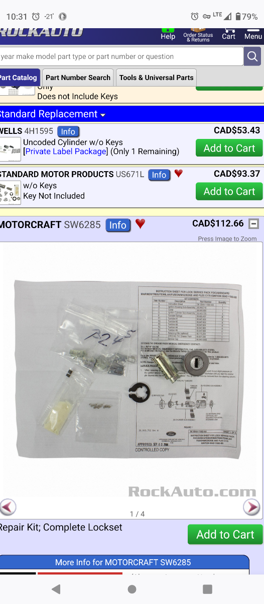

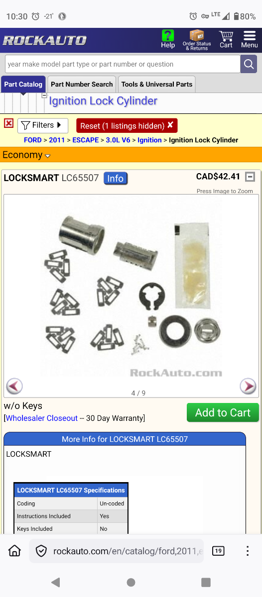

So I looked on rockauto and found these;
20011 escape key problem
One is less than half the price than the other, but doesnt show instructions included. Is this what I need? I'm going to stop by the local dealer and see what they have also.
I want to try pinning this myself, is it possible?

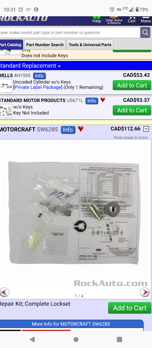

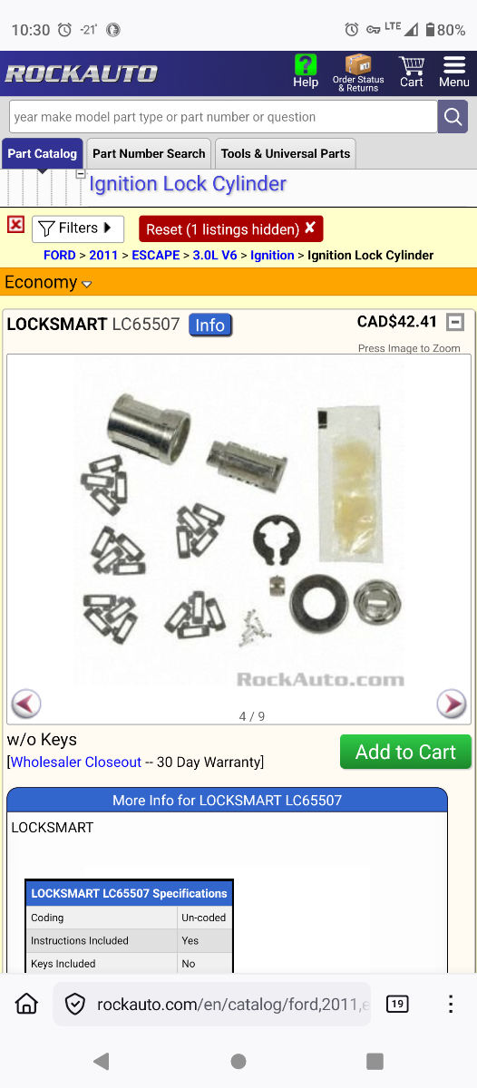

View attachment 137146View attachment 137147
It’s just a wafer lock, little fiddly with the tiny springs but pretty simple to do, you just have to find the right wafers to use to match your keys.
I stopped in at the ford dealer. $139 + tax, order monday, in on Tuesday. Ordered it from Rockauto for $67 tonight (Friday), delivery Tuesday.
