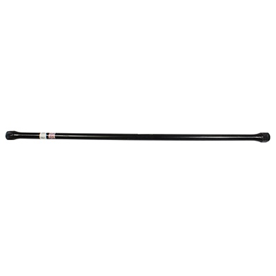

F57Z5B326A - Front Suspension: Torsion Bar for Ford ImageF57Z5B326A - Front Suspension: Torsion Bar for Ford Image Placeholder
Torsion Bar
Part Number:
F57Z-5B326-A
Options: Right, Front Right Right
Other Names: Bar Torsion
Description: Ranger. Code b. Right. Awd. 4wd with torsion bars. Explorer, Mountaineer.
Notes: Order by code.
MSRP $135.67
$105.01
ADD TO CART

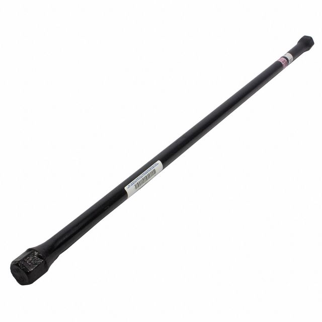

F57Z5B327A - Front Suspension: Torsion Bar for Ford ImageF57Z5B327A - Front Suspension: Torsion Bar for Ford Image Placeholder
Torsion Bar
Part Number:
F57Z-5B327-A
Options: Left
Description: Ford Parts are the Only parts designed and built to the specific Standards of Ford Motor Company and are the Only parts recommended for... More Info
