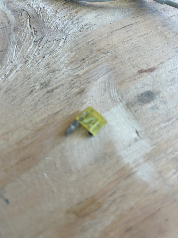

Thanks for your help. I found the issue. Fuse #43 had a broken leg. I had done voltage checks across the fuse but didn't pull it. Just strange that it failed at the same time I was doing the dash work.
Thanks again for your help!
