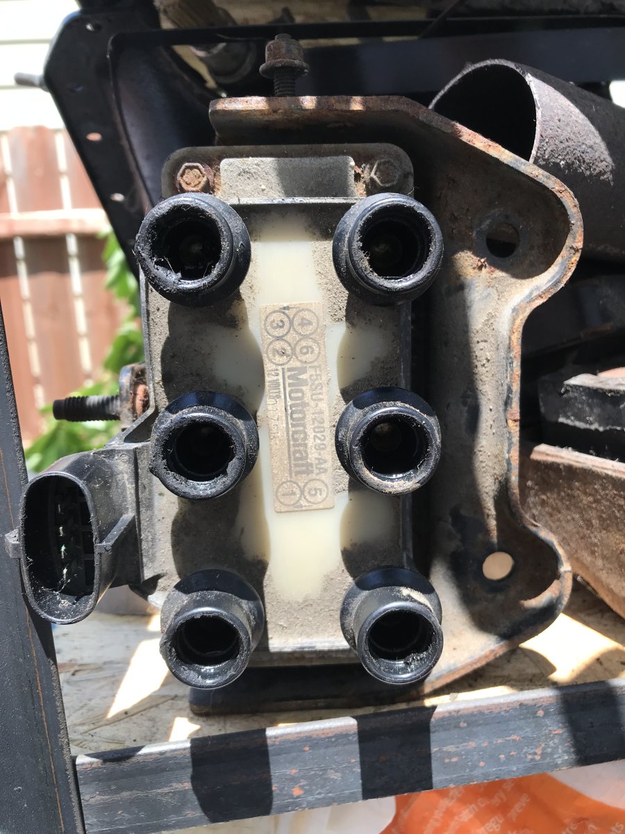

hold on a minute.
on the coil one side is in order, 1-2-3
the other side is not in order, 5-6-4
EDIT:
that might be what Haynes says, but the pic of a coil I pulled from a 2000 3.0 says different.
both from the front.
verify your coil is marked like that.
each of the 3 internal coils in the pack fires 2 plugs at the same time.
if one fires then it's partner should also fire.
on the engine, front pass is #1, front driver is #4
you can check spark by pulling a plug and holding it against the engine, then crank.
Yep that’s how it’s on there, I just pulled plugs and 1-2-3 look perfect, 4 was wet and black 5-6 just black. Getting ready to perform compression test. Also used a noid light just confirm injectors are getting signal
here is a pic of a 2000 coil, there seem to be some discrepancies.
if a plug is wet the injectors are working, spark not so much.
by the way, the cam sync sets injector timing. if it's 180 off you will still get spark but fuel may be way off.
waste spark system fires all plugs once every revolution.
