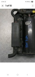

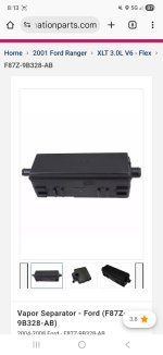

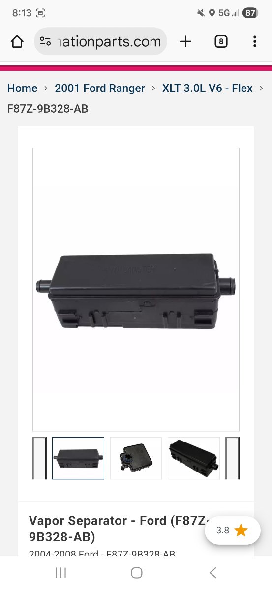

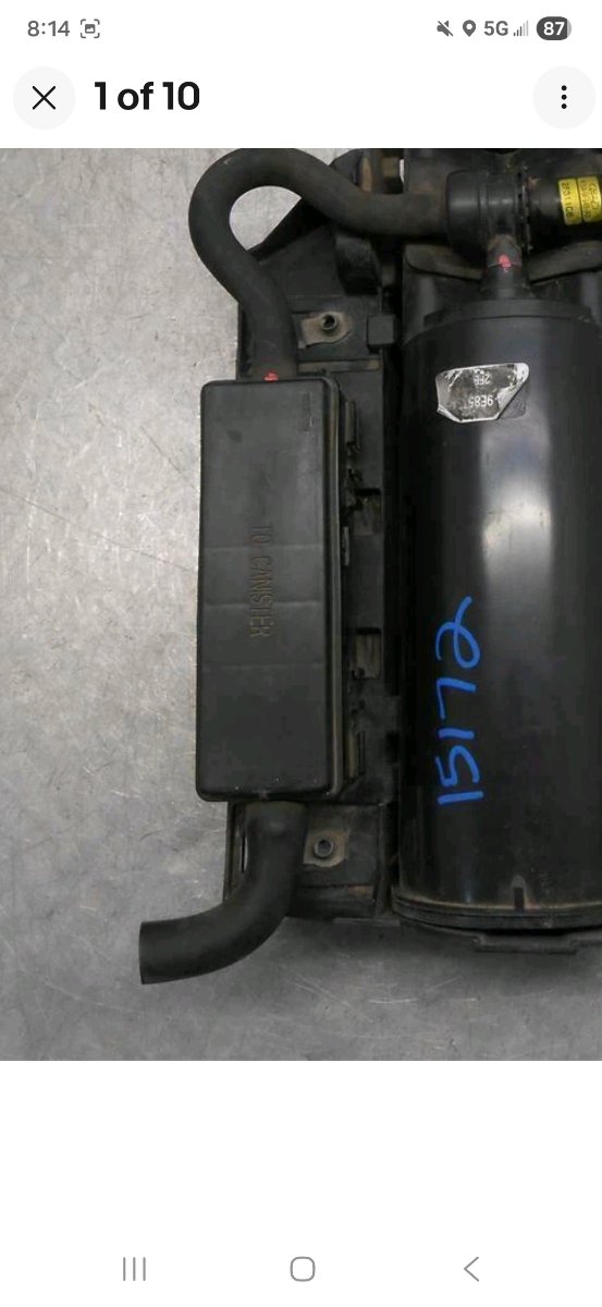

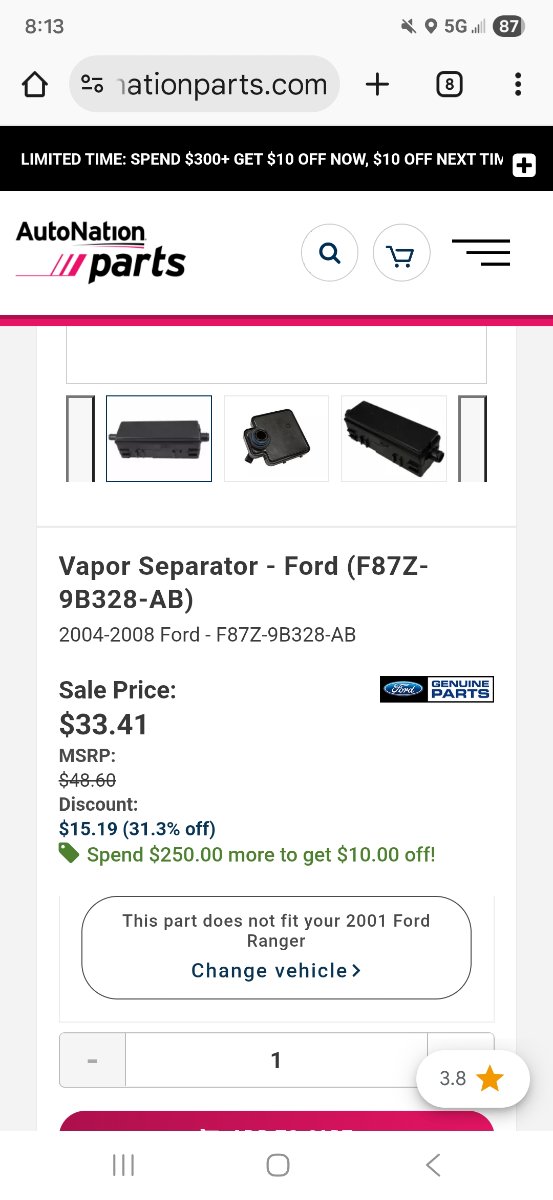

Yes, P0455. When I got the truck, I had several codes, this was never one. I replaced the underhood purge valve (whatever my reasoning was a year ago, possibly and idle or vac issue). Then a short time later, I noticed the gas tank to charcoal canister was not connected. It seems after I connected it, the code started to appear. I think today I am going to disconnect it again and see if/when the code comes back. If it doesn't, I may replace the charcoal canister. There is also a box that a hose goes from, to the solenoid, but that box is impossible to find and the one I did find, says 04-08 Ranger.
vapor canister purge valve fuel vapour separator​
