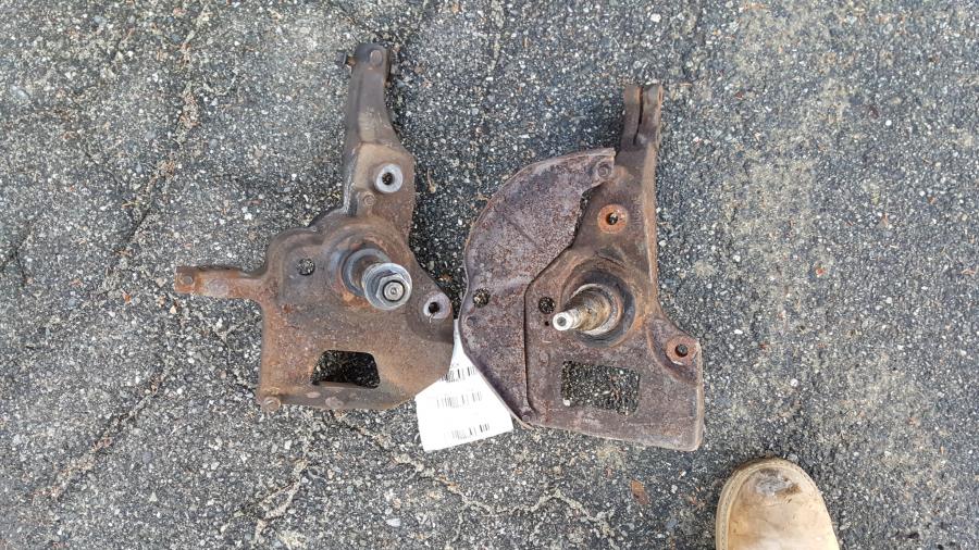

I have 2000 Trailhead edition ranger. 4x2, torsion bar suspension. My dilemma is, I need to find a used drivers side spindle. The standard 4x2 ranger spindle is too small, and obviously the 4x4 spindle / knuckle won't work. Anyone have any thoughts where I can source this part? Any parts truck or junk yard truck I find will almost certainly be a standard 4x2 suspension truck.

the spindles are different between coil springs or torsion bars. they are not interchangeable. the overall size is different, and the top hole is different.

A standard torsion suspension ranger does not have the same spindle. The picture in the OP is the comparison of a standard spindle, and the one off my trailhead ranger. I am thinking that the Edge edition is the one I need to find. Can anyone confirm 100%?
in the picture the spindle with the tag appears to be a coil type? the top is reversed, hole should be smaller.
what is the size of the top pinch holes?
what size is the rotor?
are the caliper bracket holes the same distance from the center of the spindle? (there is a 3/8" difference between 11.25 and 12.0 rotors.)
does your trailhead have 12" front rotors?
for torsion bar suspensions there is a knuckle for the 11.25" rotor, and a different knuckle for the 12" rotors.
that's in addition the to third type that is coil spring only that's also 11.25"

In the picture the spindle with the yellow writing is the one from the junk yard. According to them it came off a 2000 Ranger with torsion bar suspension. I have no way to verify and sent it back.
My rotors at 11.25". Are you saying I should be able to pick up a spindle from any torsion ranger 98+? The junk yard mistakenly gave me a spindle off a coil ranger?
that's what it looks like, a coil spindle.
