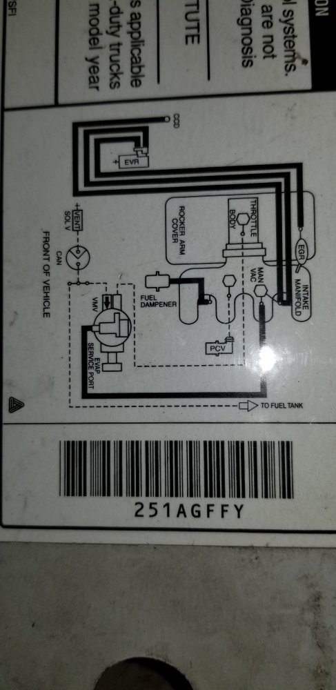

The vacuum reservoir is fine but don't know which one represents the vacuum reservoir (see pic below) Looks like I have 2 lines coming out of the vacuum reservoir, one line goes to the cab the other line was broke. Assume that one is the one to go to the intake but do not see any place to plug in to. Also found another line coming from the cab but not connected to anything. The vacuum line issue appears to be part of the problem. Also notice when AC turned on the clutch on the AC compressor tries to engage but slips.
I plan to replace both of the vacuum lines going to and from the vacuum reservoir, what size are these lines? Are they 3/32" ?
https://www.ranger-forums.com/sohc-.../99-ranger-gray-vacuum-line-pass-side-140760/

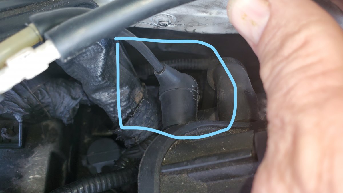

I recently purchased a 2002 Ford Ranger 2.3 and had the exact same problem. I replaced all the vacuum hoses and to and from the vacuum reservoir and still no fix. I took my vacuum tester and found that the L connector from the intake manifold was bad, but I cannot find the replacement part. Here is a picture of the problem. Does anyone know what this is called and where I can get it? Thanks
