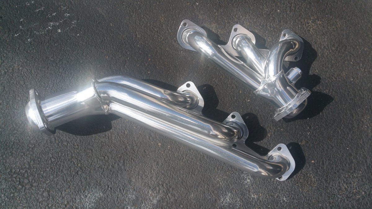

I ended up buying the JBA 95-97 specific headers and Y Pipe that I won't be using for the old 2000 Ranger. Just so everyone knows the 95-97 specific headers will fit the 98-2000 4.0 Rangers like a glove.The only reason they say the 95-97 headers won't fit is because the stock exhaust won't bolt up on both sides to the headers. With a little modification from a good muffler shop you could easily have your stock exhaust fabbed up to fit. .The headers are 409 Stainless and I have decided to have them Ceramic coated inside and out because I drive in snow,ice and badly salted roads a lot in the winter time. I have the Stainless Y Pipe brand new and won't be using it. Hoping the truck picks up a lot of power when I finish getting g it together..!

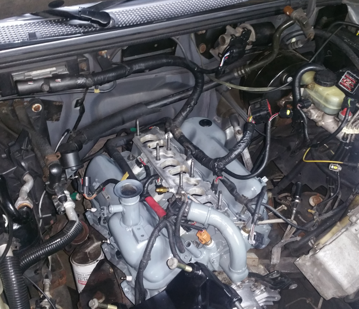

Hey Schul...cN't leave you hanging. Your posts helpes me tremendously. I thought that 8-900rpm at idle was normal. That's where my 4.0 OHV is. It is running strong with the heads from King. I had a bit of an issue with exhaust leakage around the headers at the heads but that was my issue in torquing. Thee was an outlet on the headers for EGR hookup, but since I have no EGR, I solved that with a 22mm end cap. I also replaced both the O2s and am currently code free. Thank you again for all your help.
Thats great to hear. This was a really fun project for me, and I wanted to help others with my learnings.

Those look way better than the ones I got. They also look easier to install.
Nice
What he said!!
Yeah you pay a price for them but I plan on having rhis truck for quite awhile for a daily driver to my work and in the winter the roads get really rough and salty so the 409 stainless and ceramic coating combined should keep them looking new for years. You can get some nice looking Stainless headers on ebay for a good price but they aren't available right now and no telling when they will be so I wasn't waiting on them..
