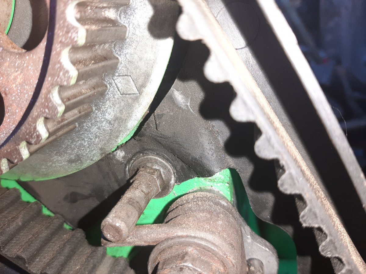

I cant see crank keyway cause i dont wanna remove it. So im going by the mark on the balancer and timing mark. Its TDC. Oil pump/aux gear whatever it is only has one mark hard to mess up. Cam gear itself has NO mark, the plate attached behind it has the diamond mark. And the backing plate has one mark. Seen here.
Wrong mark for cam gear(in the picture), that's a Diamond, you need to use triangle mark on Cam(4:00), Diamond on AUX(12:000)
Why is there two f***ing marks? I found the triangle.... wtf is the Diamond for!?@?@?@
Im throwing another bird feeder at this thing. The second mark is like 120 degrees off?!?!?
Seriously tell me. Why are there multiple triangles and diamonds... also tell me... why don't i put this thermite in the truck and give up on life altogether?
The Cam gear and AUX gear are same part, same part number, interchangeable, but use different timing marks depending on where they are used, on the Cam shaft(triangle) or on the oil pump/aux shaft(diamond)
The god damn aux gear has two triangles....explain that... which baffles me cause that gear only drives the oil pump so why does it matter? Except some idiot put a cam sensor on it!!!!!
