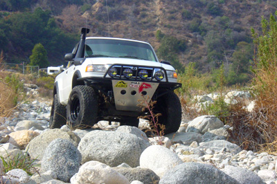

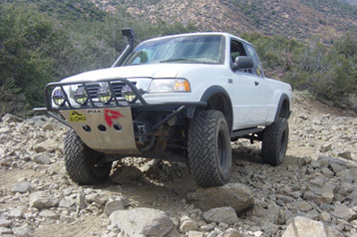

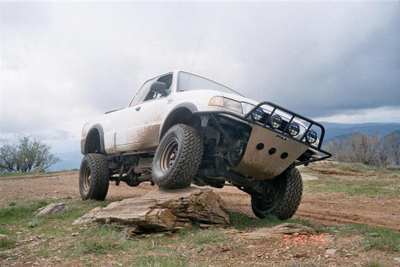

Heres some pics...

The truck looks SUPER sexy, impressive unit!!
