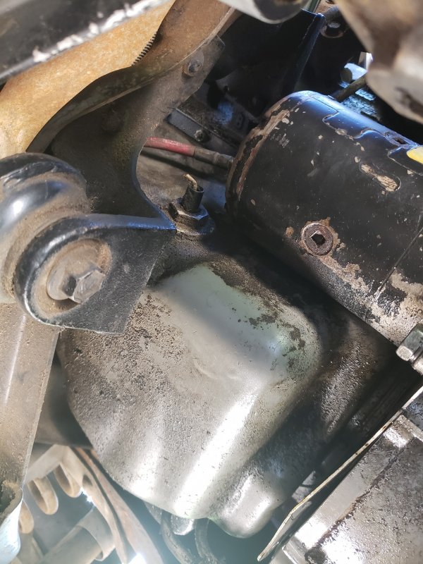

2. There is also something disconnected that I am not sure what it is (See image below).

2. What is the sensor/thingy in the image below with the wire to nowhere, and what does it do?

Change your coolant temp sensor (the 2 wire plug one) and try that. Did you pull codes?
That sensor is just an oil sensor and it turns on a light on the dash if all of your oil pours out somehow.
