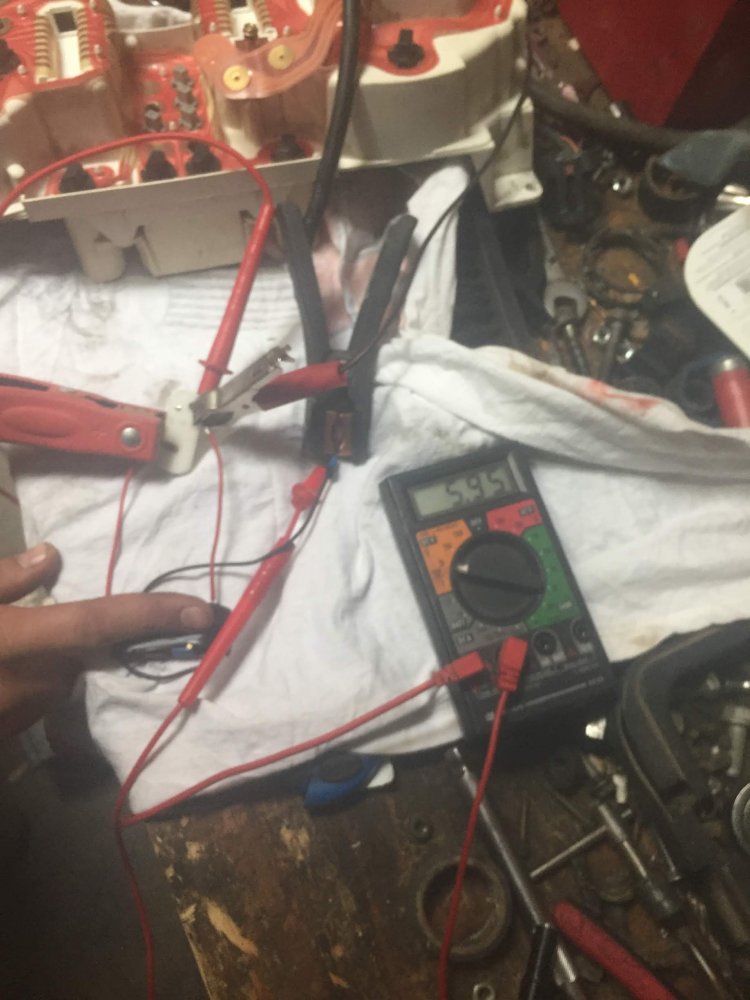

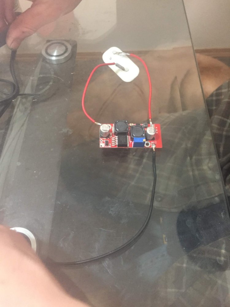

PROBLEM SOLVED... so far so good.
All that was done in the end was changing the voltage regulator in dash
to a new part from electronics store that converts any voltage under 24v (fluctuation in voltage allowed) to whatever you set it to.. Set it to a steady 5.95v. SEE IN PICTURE, set volt output with tiny screw in blue box on chip board. Solder it to old pulse regulator terminals and a ground.
