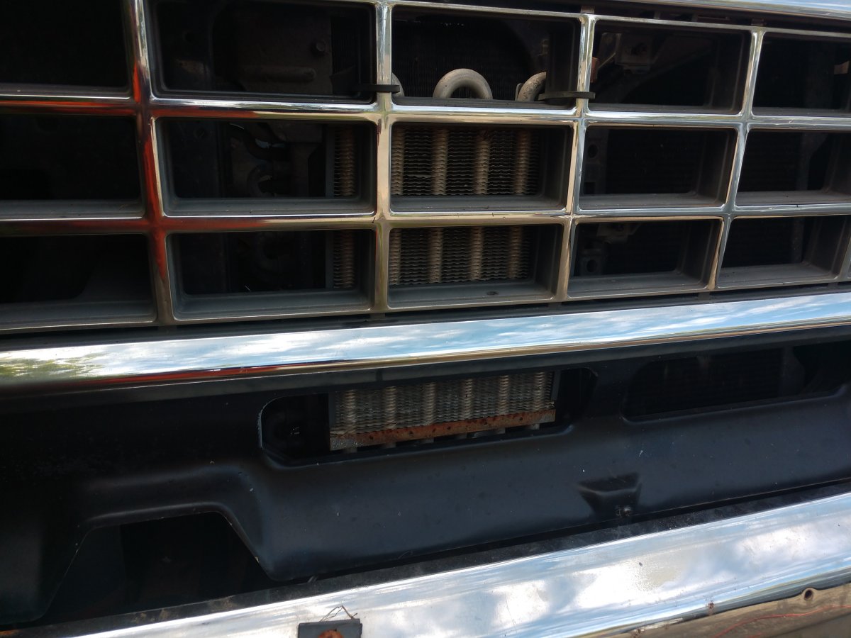

It has both a thermo flow valve and a cooler.
Here is the cooler location.

Is the cooler behind the grill a kit for the oil cooler or did you convert a transmission cooler for use as an oil cooler? I saw a tranny cooler conversion on YouTube.
If not, how where did you get both the adapter and cooler kit from? Looking forward to the pics. Thanks.
Ranger101:
All 3 devices were sourced seperatly from Summit Racing:
The cooler is an Oil Cooler kit, I chose it because of the tubing size and passes. It wasn't much of a kit though, just the until, hose/clamps and 8 stopper zip strip devices but it worked.
The thermo valve came with the wrong size Barb's but I really though that it would help with engine warm up so I replaced them with the correct size. The remote oil filter adapter came with some hose and clamps.

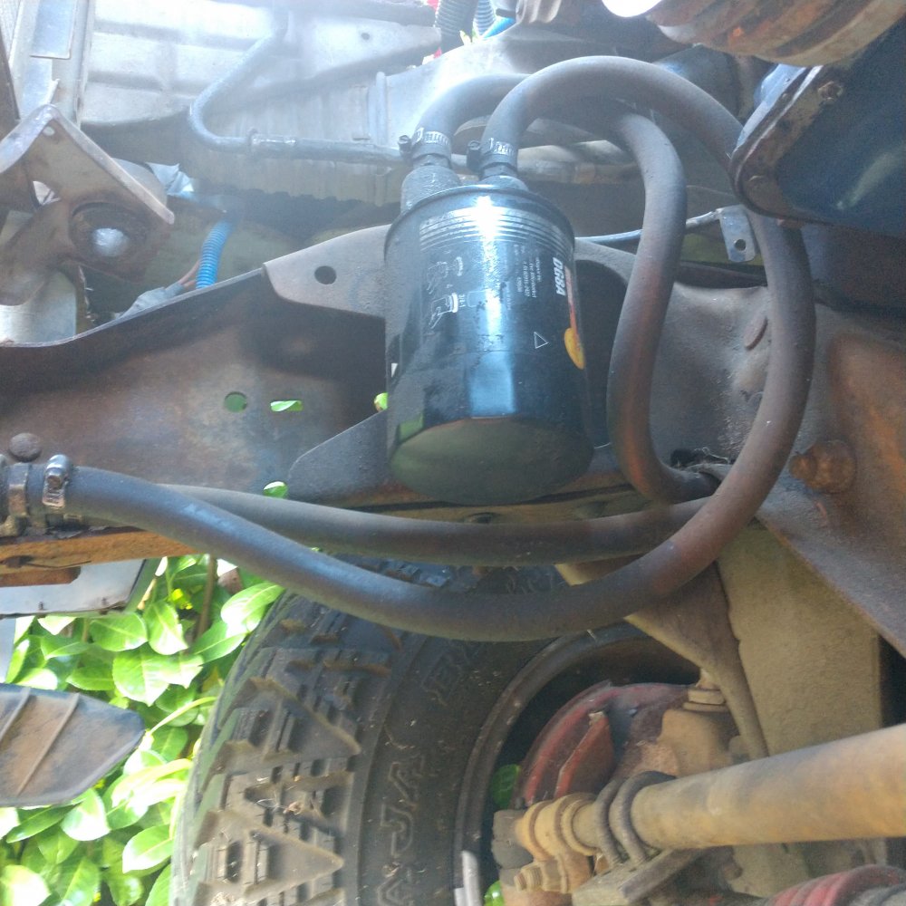

Remote oil filter and pluming through the frame.

Thanks. The pics and insight are VERY helpful. I’m researching all three and have a feeling that all three will find there way to my 89. I’m going to spend time researching kits, cost, and location under the hood.
