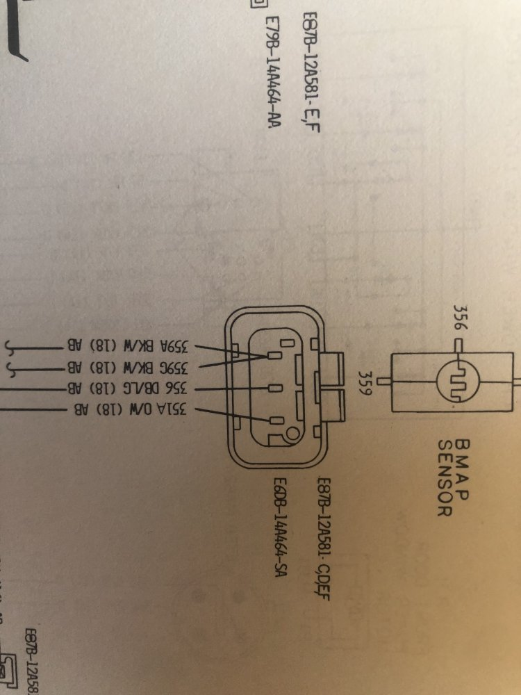

I was pretty confused looking at all that on my phone. I'm on my laptop now.
So this shows the different connector part numbers... got it. Very helpful.
So... get a repair connector for the later MAP sensor... splice it into my older harness... use later MAP sensor. Like hitting the easy button. If any of that is even the case... I don't see a second end view saying there is a physical difference.

If you need a view of something else I Will gladly send it to you . Is your part number E6TZ-9F479-A ?
