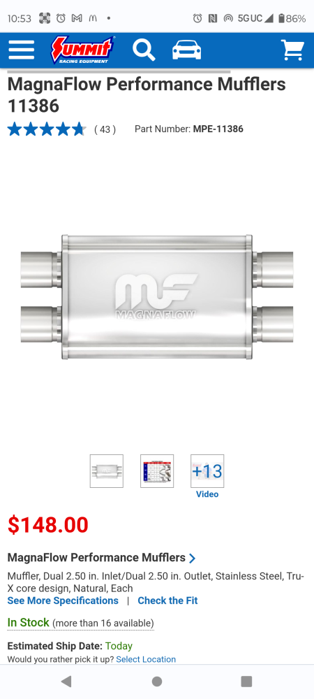

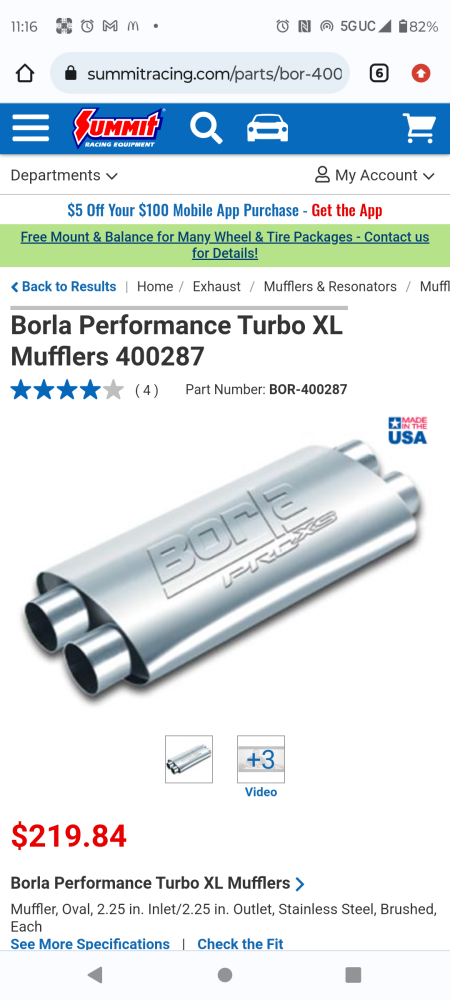

If you are set on a cross flow, Borla makes a dual in/dual out muffler in 2¼" (called Turbo XL but that's just the former name for the current ProXs model) that could be used with 2" tubing with modest adaption for a true dual 2" tubing system; that is what I would use.

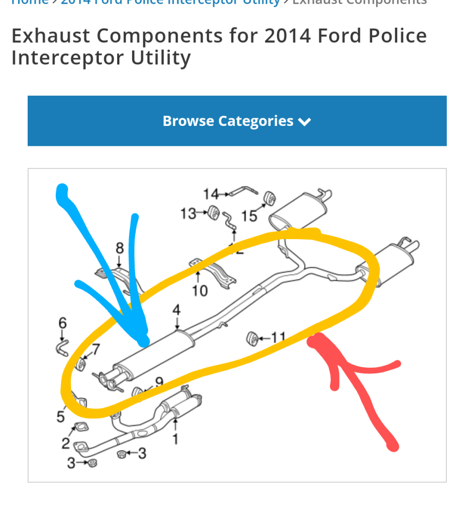

Another company that I would use is Magnaflow. Ford uses a similar muffler, though a bit larger on their 2014-2017 Explorer Police Interceptor Units; it would be a much cheaper way to go about it, using a wrecking yard pull. It is long though, it looked like a solid 24" long. This PIU exhaust is a 2" dual exhaust, from the wrecking yard should only set you back $50-$60 for the entire mid section (marked in yellow or just the resonator (blue arrow).
