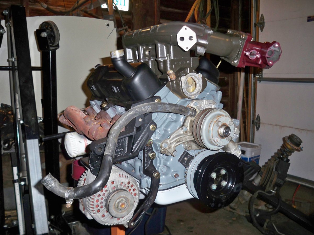

I run the merkur upper on mine - is better than ranger one. Linkage is hard to come by, though.
Theres three types of lower as well - standard, high strength, and merkur. Merkur has extra coolant ports.
Timing on dohc is 2.4 meter chain iirc. Good luck lol
3g alternator is worth it.
I forget why I didn't go with the mr2 pump... I think it was availability. Epas conversion on mine was somewhere around $150 all in.

I have two merkur uppers, one is on my Scorpio lol. And screw that linkage, I just made a bracket that accepts the bare cable after I trim the end off of it to expose it. Still need to figure out the ratio between the pedal and the throttle, but it should be easy to just adjust it on the manifold end. And what is this 3G alternator I keep reading about? Like what applications were they on? I was just gonna buy one for a mustang from jegs or something and wire up the exciter and the charge warning light to it, but apparently this 3G is a better fit.
Mine came off a Windstar van with a 3.8. I think.
Bigger alternator that adapts easily.

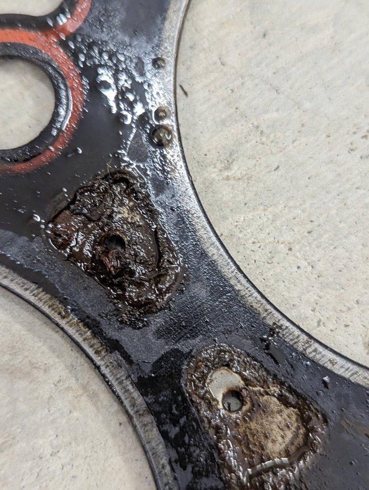

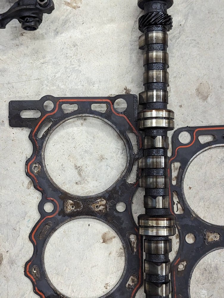

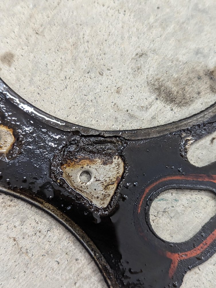

Finally, something went wrong. Head gaskets blew. And it wasn't even from boost. Someone in the past couldn't keep half-decent coolant in it, corroded the compression rings and started consuming coolant and putting combustion gases into the cooling system.
In the process of doing it, I pulled the timing cover to replace the chain & guide set and pulled the cam & lifters to inspect everything, all seemed well. However since this engine has been apart before (fel-pro head gaskets coming off) I can't tell which way the cam retainer plate is installed. It clearly has a path for oil to flow, but the plate covers two galleys, so I don't know which galley gets the path, and which gets covered completely. I also read about installing it upside-down to remedy oil pressure issues. So which way is it? or, does it even really matter? Also, with it being a possible 'bleed point', with oil pressure and no gasket, same with the tensioner & oil pump, would some thin paper gasket material help at all with any bleeding? Or is it best that I don't bother, and just put it back together as it came apart... No issues before, I can't imagine any that could develop, at least in the near future.
