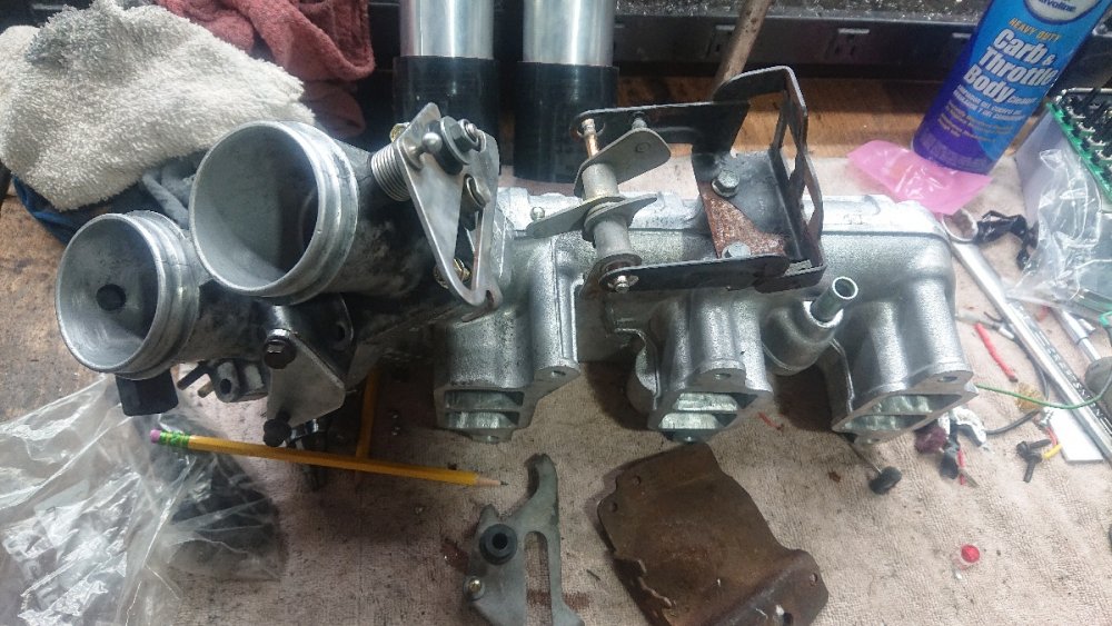

Am considering picking up the lower intake they have listed. Figures. I put so much porting work into mine... ?
I'll probably submit a tech article on this when I'm done.
In the meanwhile, in order to adapt the Scorpio intake, you'll need throttle position sensor 86 TF-9N 989-AD and Standard Motor Products S-745 connector / pigtail.
The original Ranger TPS sensor and pigtail on my 1988 did not fit, nor the ones off my 1986 throttle body.

Finally found a partial Scorpio intake throttle cable bracket.
WTF IS THIS CONVOLUTED NIGHTMARE?!?

@PetroleumJunkie412 I know you've been running this setup for a while now. Do you have enough info to share for a tech article. Parts needed? Benefits? Pros/Cons? Any gain in performance? Mileage?
Torque curve moves up in rpms, much better throttle response, seat o the pants dyno says "improvement." have half the tech section article done ?
Parts list wasn't too bad. Bolts and throttle cable were hardest to find, but I probably should have a custom throttle cable made - ranger one is incompatible, and merkur one is a few inches too long.
Jeff Herston over at Merkur Parts Midwest had everything in stock I needed save for the bolts; those and the matching gasket washers came from River City Fastener on ebay.
It's absolutely worth doing. 2.9s rely on revs to make power, and the twin snorkel intake frees up the intake side. Saw an average 12% increase in volumetric efficiency across the board with the merkur vs ranger intake manifold.
I really want to hit a dyno with both in hand to see the difference. Hopefully summer when it's out of hibernation.
