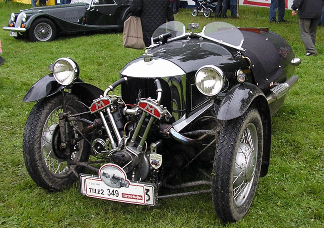

Found this in the meantime for entertainment
I suppose part of the point of this is that I keep thinking about the design (of the 2.9 in general) and wondering how much potential is really there, and if the Morana prices are really worth paying...

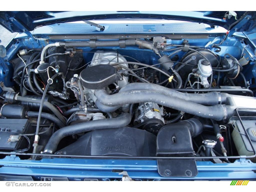

A late 80's to early 90's F150 airbox and intake piping might be handy for you?
