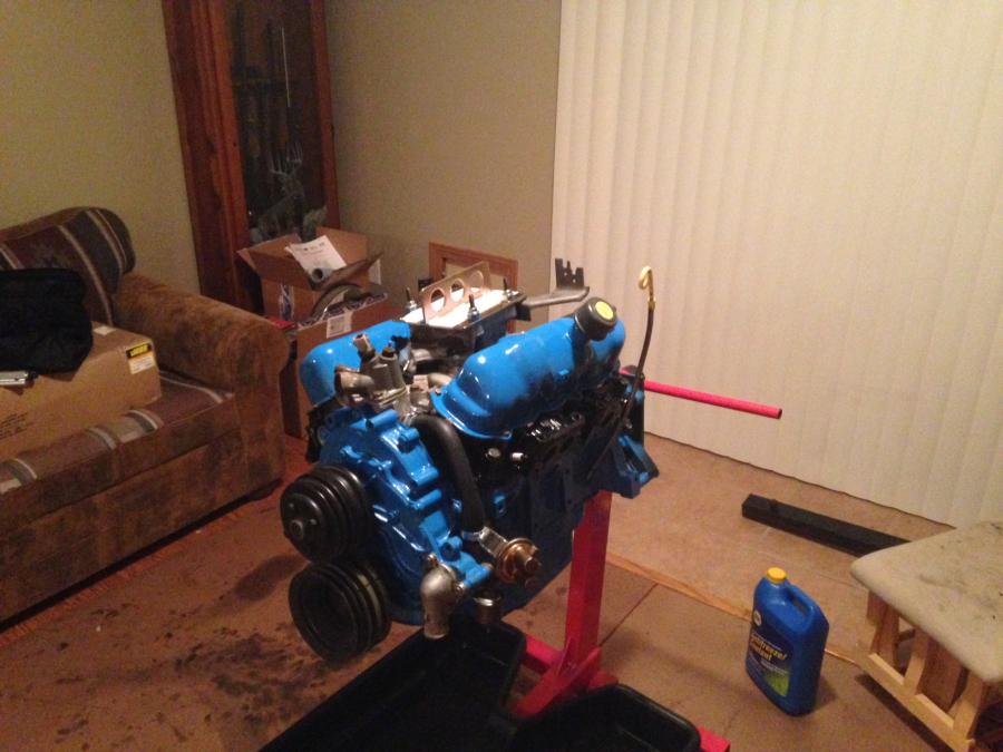

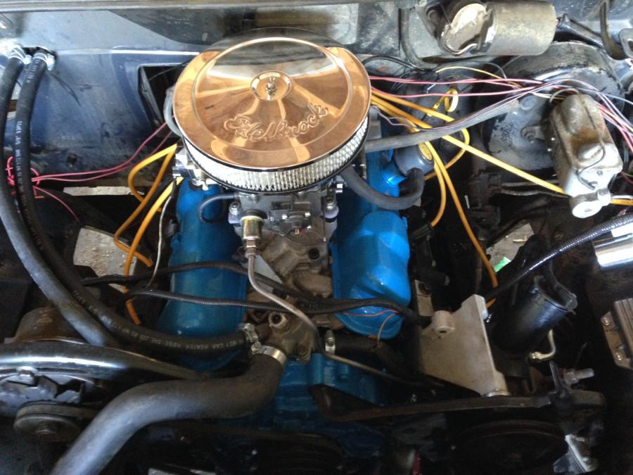

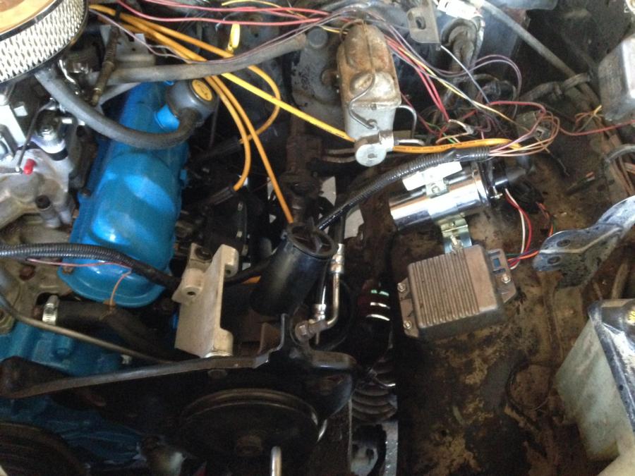

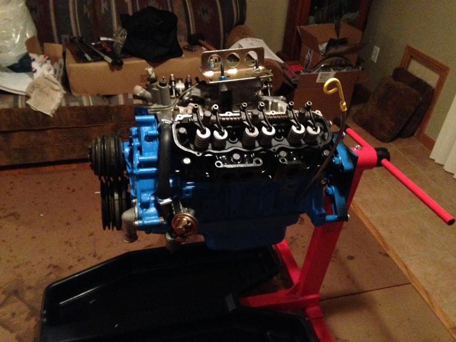

Finally got everything in and buttoned up. She runs like a champ. 100% de-smoged and de-computerized. Followed the duraspark instructions from this site and had zero issues. Didn't get to drive it since when I stepped on the brake to put it in gear a brake line burst. Have a few pictures of before and after it went in. And yes I did build this engine in my basement over the winter. All in all not too hard or expensive project and got a nice vehicle back on the road.

I would think it would have to be ignition related, if it was fuel the whole thing would run crappy not just miss. Are you running the stock Ignition system? If you are I wouldn't be much help, there's a lot of sensors that just don't last, and I'm not even sure how that whole system works, Carbs and computers should have never been used together. I would recommend the duraspark conversion rather than trying to track it down. There's a good instruction page on here. I got all my parts for it off of rockauto.com rather than try and find a scrapyard with an intact ignition system from the 70s, the parts really weren't that expensive new and then when you're troubleshooting you don't have to worry about whether the parts you used are actually working. Anyway, if you're already durasparked there's not much to go wrong, spark plugs and wires would be a cheap easy start, along with checking the timing
