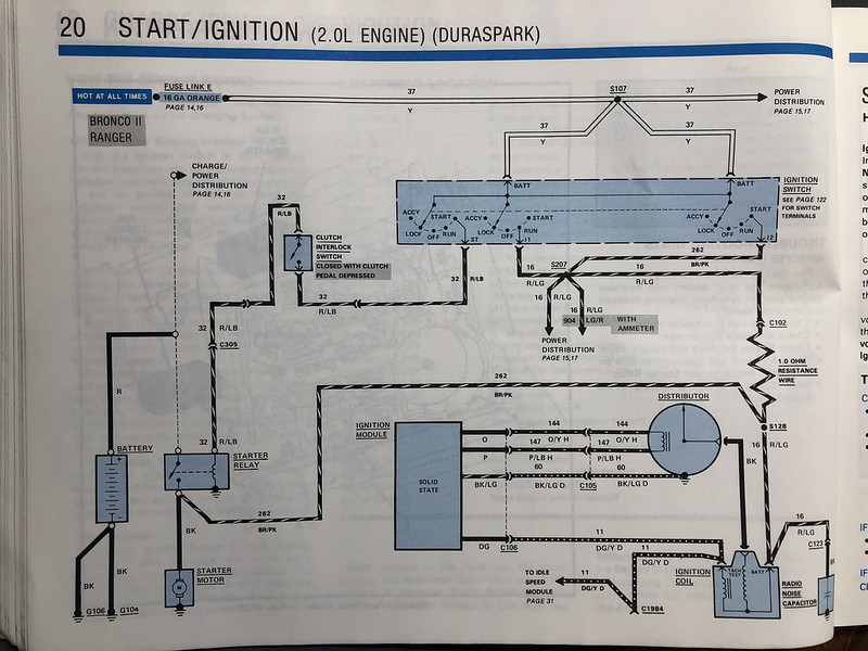

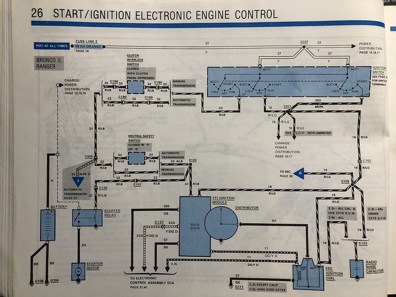

I only have diagrams back to 1986 but no resistor was used, except on tach signal to computer
There were two separate wires from ignition switch for RUN and START, from the old resistor days, but they were spliced together
And I thought Rangers used the same grey TFI module from 1983 and up
That is odd
This is from the '85 EVTM
'88 EVTM
The 2.8 had TFI but when you convert to duraspark you don't care about that, everything else needs to be like a 2.0 not a 2.8. This is the 2.8.
So Duraspark module specific not TFI, got it

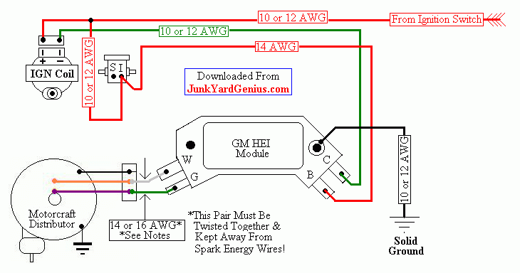

I believe y'all are talking duraspark modules, but I'm using the square TFI coil on my '85 with the GM HEI with zero issues so far.
All I had to do was run + and - from coil and hook up distributor. The rest of the wiring is stock from the '85 B2.

The HEI module will take the 12v power without using a resistor. It has current limiting circuits inside it to let it be hooked up this way. The duraspark II module requires the resistor to limit the current through the coil, which then limits the current through the module. Like someone mentioned in a earlier post, a duraspark II system without a resistor will make the module run hot and not last very long.
Some people use the square coil with the duraspark II module and don't have any problems. I am hesitant on this also, the square coil draws more power, and this power has to run through the module. I also don't like running "hot" aftermarket coils with the duraspark module. These other coils may work fine, but I like running the original horseshoe connector duraspark coil.
