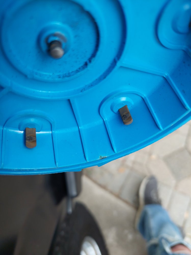

Distributor cap is looking pretty corroded.
Stop looking at my legs. :blush:
Cap looks fine, I’ve seen some that are damn near melted though the contacts that ran fine. Little sand paper will clean that corrosion up.
