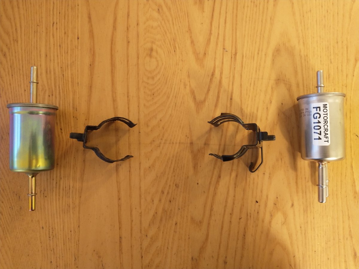

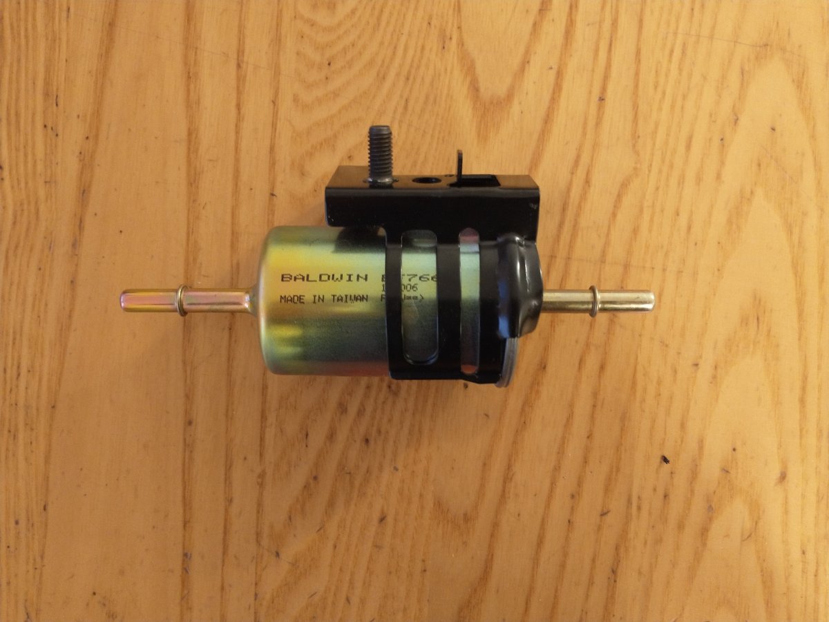

For anyone interested, the Motorcraft FG1701 fuel filter mounting bracket works with the 2.5L fuel filters. The mounting bracket on my fuel filter was completely corroded and broken, and I couldn't find another bracket specific for a 2.5L filter. The Motorcraft FG1701 filter looked similar in size and came with a mounting bracket so I thought I'd try it, and the bracket fits perfectly on my 2.5L filter.
