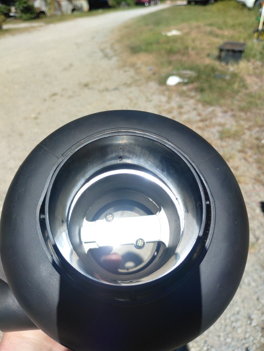

I got a reader, now i am more confused, the fuel trim long term is at -17 ond short term is calling for -8 to -15, it keeps leaning out and changes the timing. The timing start at 10 or so and works it way up to 25 at the same time it is leaning out; when it get to 25 it has a closed loop fault and goes into open loop. Tps reads good, iac seems fine, i put another 02 up stream in it yesterday, and put a different maf sensor in. I am at a loss thank you
