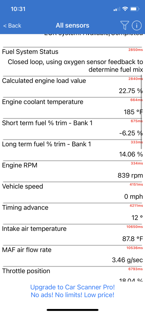

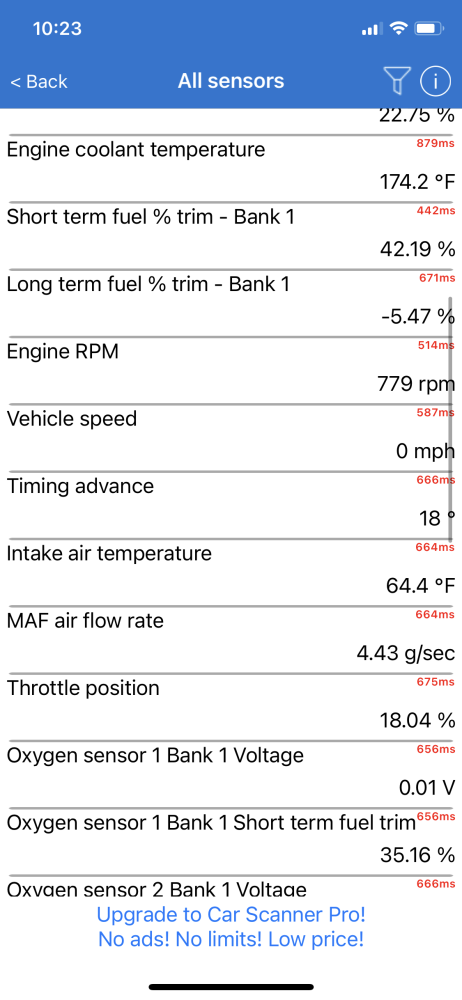

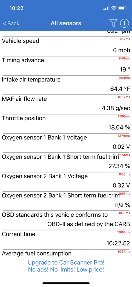

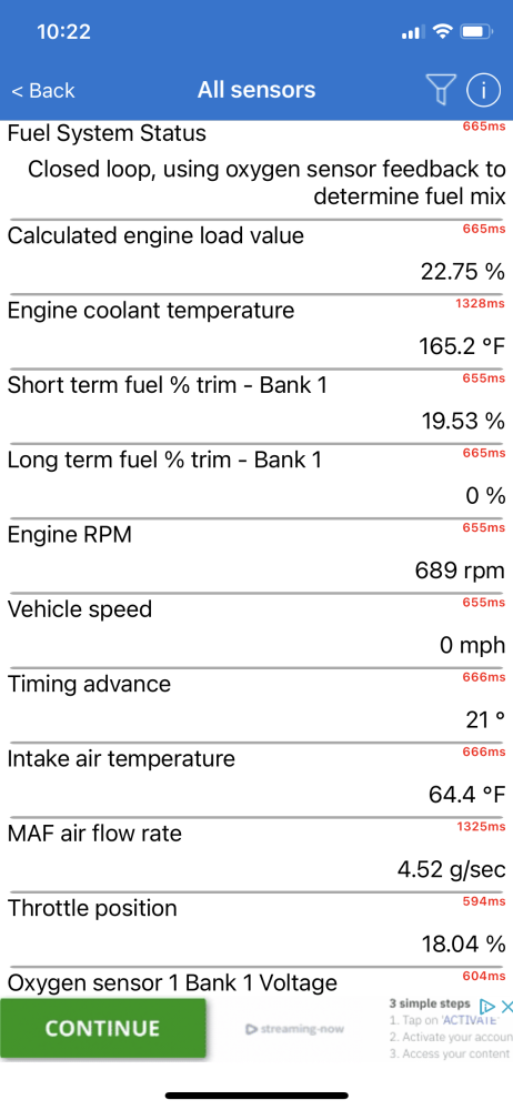

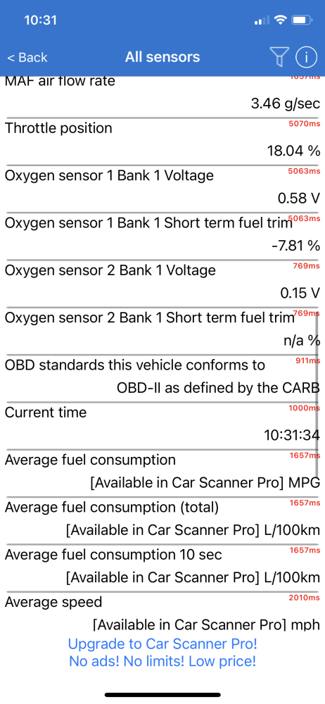

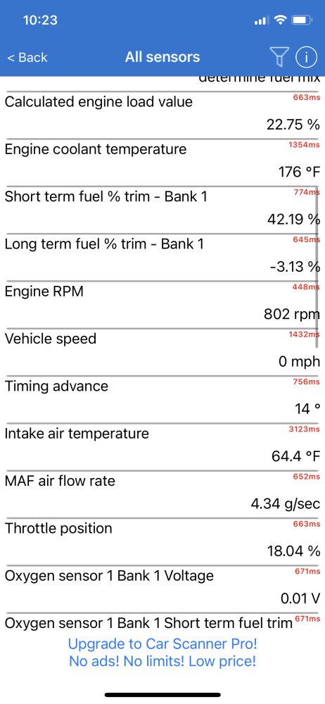

I recently picked up a 2000 2.5 manual ranger. Seemed to run great on the test drive. Motor has 197k on it and has reciepts for a rebuild at 176k. First day I drove it to work I let it warm up in the driveway while I made my lunch ran fine to work. Leaving work it didn't have time to warm up and once I got to the second stoplight and came to a stop it started idling horribly shaking vibration almost stalling. Had to crack the throttle to keep it running. Once it got to full operating temp it smoothed out and was fine. Does it everything single time it's started from a cold dead sleep. I've done plugs wire fuel filter pcv valve. Test egr by sucking on it. Iac looks new. Cleaned it anyways. Cleaned maf and map sensors. Can't seem to find a fix for this. I've never owned one before so have nothing to base it off of but it seems pretty under powered. Checked compression and got 150 on all 4 cylinders on a cold motor. Could it be a timing belt issue? It looks original. Possible leaking valves? Never had an issue like this and I'm baffled.
Also, mileage appears to be complete garbage. Fromwhat I've calculated im
Getting 14-17mpg.
Once warm it isles pretty good. Some days the idle will ramp up and down slightly or surge but usually will idle smooth once warm. Also no CEL or stored codes. I have noticed a exhaust leak type noise under load between 1500-3k rpms. Haven't been able to locate an exhaust leak though. Also put a vacuum gauge on the port where the fuel pressure regulator line connects and got 18" of vacuum.
Also, tested for vacuum leaks with propane and brake cleaner, can't find any leaks. Sometimes unplugging the aic lowers the idle sometimes it doesn't. I have a Bluetooth obd2 and the fuel trims go nuts when it idles rough like it's trying to compensate. I read the ecu is in a open loop while warming up. Wondering if it's something with switching from open to closed loop program in the ecu when it comes up to temp?
Here are some screenshots during a rough idle warmup. Also I want to try to WoT injector leak start test but I only 89% throttle position at wot. Does that sounds right?
