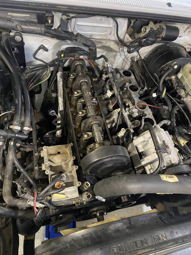

Got it torn down this far to replace exhaust manifold gasket and injectors. Check compression again and had 165 on al 4. Think I should have the head rebuilt anyways since I'm this far? Everything looks ok visually but it also took awhile to get this far don't want to do it again lol

Going to pull the head and have it rebuilt. Pretty sure the have the recessed valve problem alot of other people have. Tried a leak down test and had a prettt good amount of air leaking out of the intake and exhaust valves
Not sure why I'm updating since no one seems to give enough of a f*ck to reply but just in case someone else comes across this with the same problem. All 4 exhaust valves were recessed. Head rebuilt along with new injectors and timing belt. Purrs like a kitten.
