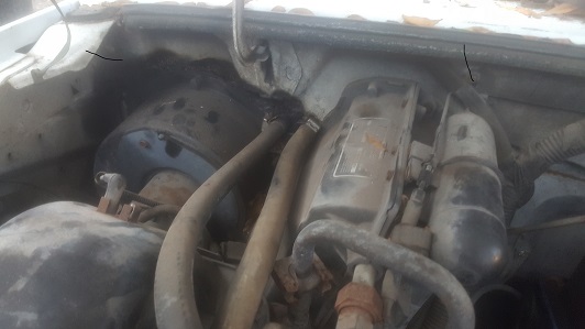

heres what im refereing to the left the spliter but where does the right go to?

I can't really tell from that angle where the hoses are coming from. If there is one that goes around to the intake side of the head that is the one you remove from the 2.5 head because there is no passage into the 2.5 head...
Does that make sense?
Once that is removed then you should have two hoses from the front of the engine to the heater box. Just remove all the hoses that otherwise go to the splitter and intake...
I remember some had a hose running along the valve cover and then splitting to go to the heater box on one side and the intake inlet on the other.

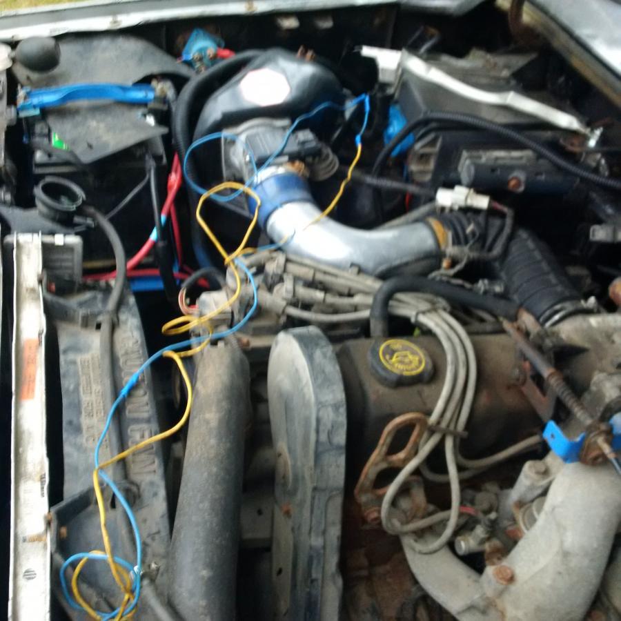

If I can find the image I had of my 2.3 it might help...I took a shot from the passenger side fender looking into the engin bay...they are all on Photobucket and that might only allow you to see one image...I will try to download them...my USB stick recently got wiped out and I lost all my Ranger build pics...
Im going to check in the morning here and i think i should be able to if not i can send a better picture i know one goes thermostate housing howevervdont know where the other goes where the splitter came from
so do both hoses coming from heater box go to something? i think one goes to thermostat housing i havent found where the other goes that i removed the split from, other than that only other problem i have is another pulley for the air conditioner and two wires i have no idea where they go, i will upload a pic tomorow when sunlight comes to provide a full detailed picture.
I finally found the image but it doesn't show much...just the two hoses from the front of the engine going along the side of the engine bay directly to the heater box...there is actually a splitter in there but you can't see it...I put mine right by the firewall close to the heater box so I could keep the hoses out of the way of the engine...much easier to work on that way.
I posted it in my previous response...in case you missed it...:)
I see it! thanks! so that confirms the right hose goes to thermostate housing but i need to found out where the left hose goes to, do you know what plug go to oil pressure switch in the back of the head
