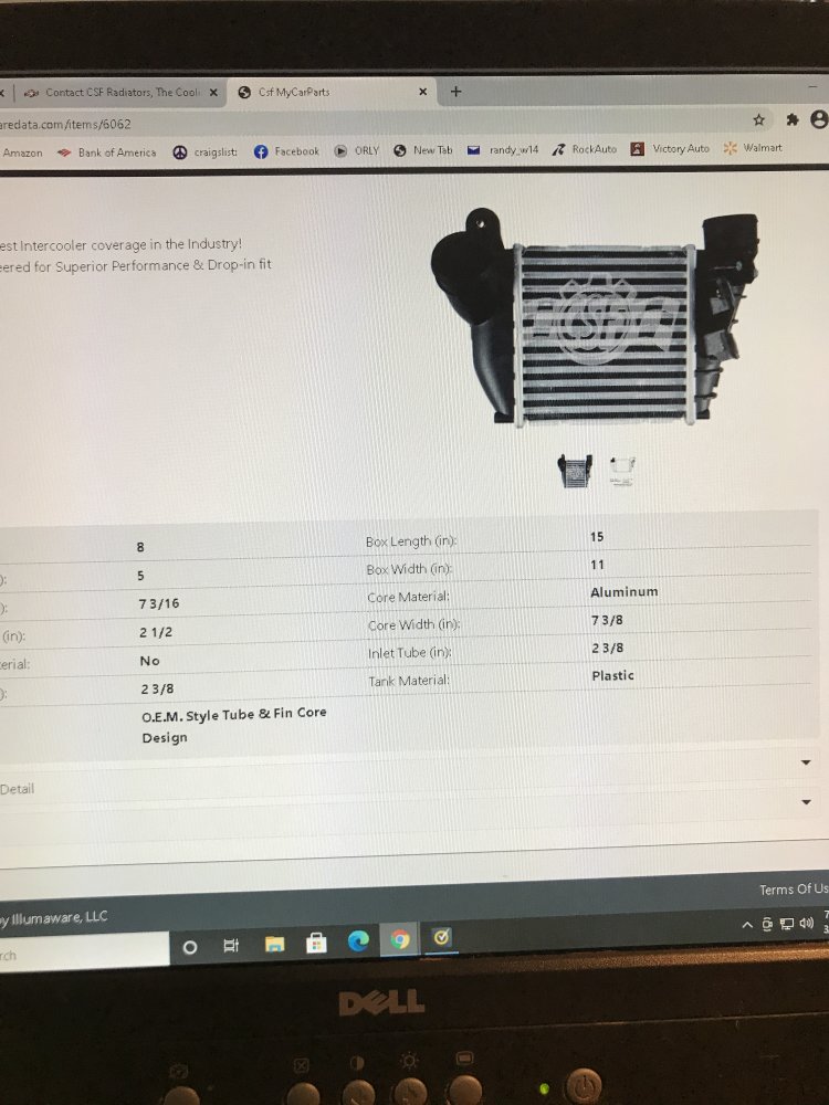

I have a question what is the biggest and easiest intercooler to fit in a 97? I can cut and modify just curious as to what someone else has done
If you stay near 7 lbs., the top mounted style 'cooler, as FORD used will be ideal. As previously mentioned, just louver the hood. Keep the intake air short and cool and this will help underhood temps will stay lower also. A VW/AUDI 'cooler as shown may work for you. You can find them on ebay for under $100.00 new. It's made (marketed) by CSF. Don't forget that the FORD intercooler was sized for ALL around driving @ 220HP. That small cooler alone added approx. 30HP. Do NOT overcool your engine. You will not get the power you desire. Also, a 1997 model eliminated the ICM. You can wire the COP ignition right from the PCM wiring. Consider using the Turbo injectors and VAM. The turbo and 8 plug Ranger PCM pinouts are on this website, I believe: Dave's 2.3 Turbo Swap page. Just Do It!
