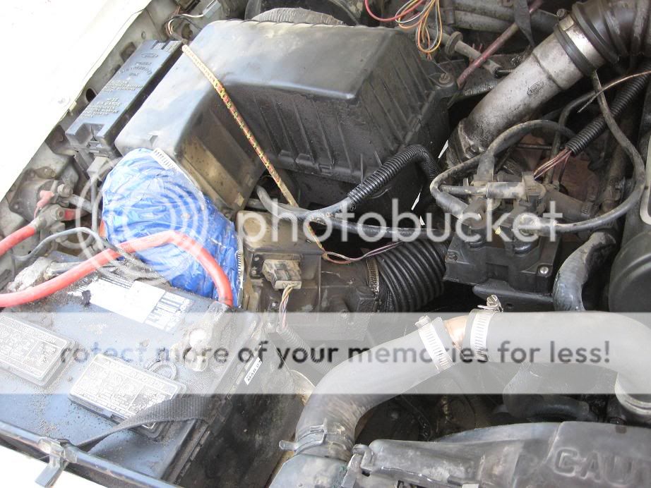

that said, I don't know if you can drop an explorer radiator in a '95 as I did in my '90, it required reworking the top hose with a copper 45* fitting in the middle and using a '86 T bird turbocoupe lower hose, but now I have a super thick radiator that I only paid $35 for at the junkyard... the first one I had was apparently plugged as it overheated at low speed high load but it also had a cracked side tank, the new one works great.
There's an older picture of my engine, but you can see the modified upper hose, over 2 years and still doing fine with that simple mod, I think it's even the factory upper hose.
