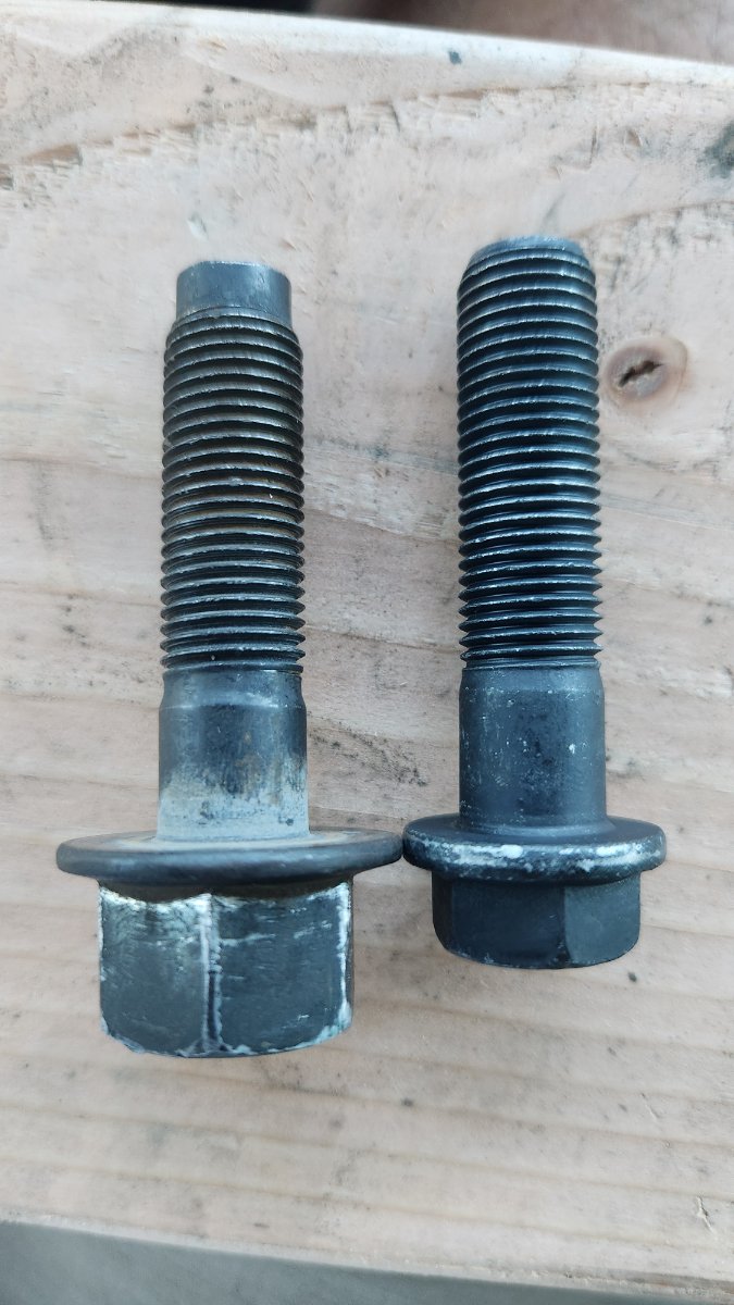

Sharing a little research and a solution. I just replaced my head gasket and am reinstalling the timing belt. I did not want to reuse the crank bolt but they seem to be completely unavailable. The harmonic balancer is available but the bolt is not.
After a lot of research I found a mopar knuckle to hub bolt from a ram 3500 is the same bolt with a jis head. Same 14x1 50x55mm at 10.9 hardness. Use the old washer, thread length is the same. Mopar part number is a 5086661AA and the Dorman cross reference is 926-171.
