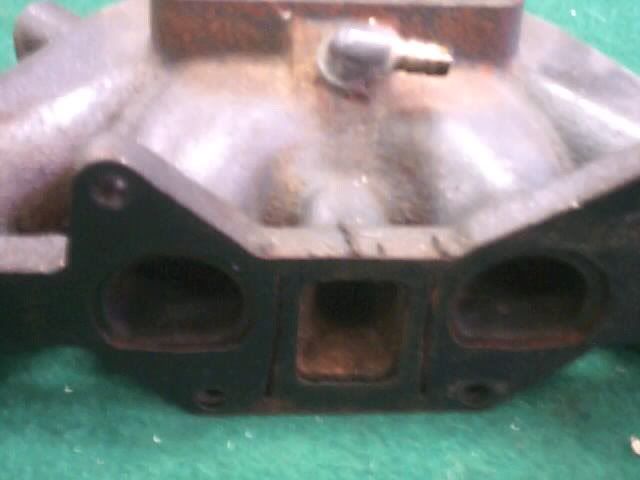

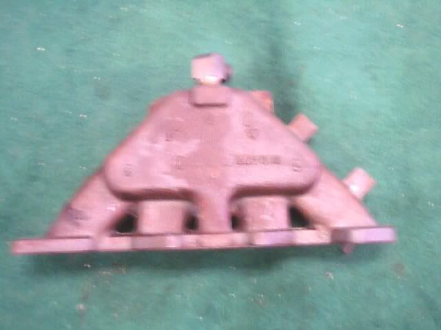

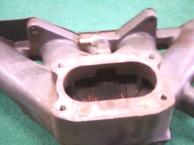

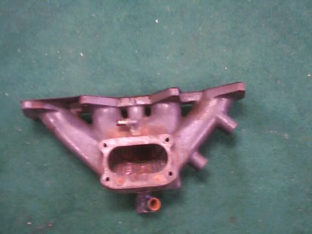

Anyone got any pictures of an OMC intake? I can't seem to find any and am curious what it looks like.
Here are pictures of the one I bought off Ebay.
It's a "d-port" style for all omc marine applications in the late 80's..
It generally uses a Rochester 2gc, and along with a Mallory marine diz touts 130-140 hp reportedly..
I actually have the manifold, carb, and diz..yet unused.

What size 2GC do you have for it? Do you know what size came on the stock OMC 2.3L?
What model of Mallory distributor do you have?
Not positive, but from what I have gathered the original OEM distributors in the 1987 through 1990 2.3L Cobras were Mallory YS point type (OMC also used some Prestolite point type distributors in 1990). However, the newer YL with the larger body allows you to convert to electronic ignition at a later date if you chose where as the older YS could not be converted.
Hmmmm...nice colour...lol...
Are you going to tap in a vacuum tree for that? The only vac opening I see looks like one for the PCV...I'd want a brake booster and vac advance for my system...
Haha, I know right? It’s got that nice rust finish; you hold onto an intake this cherry…:cool:
I plan on sanding the shit out of it and painting it up, along with what you suggested – tapping a vacuum tree for the brake booster and vacuum advance.
