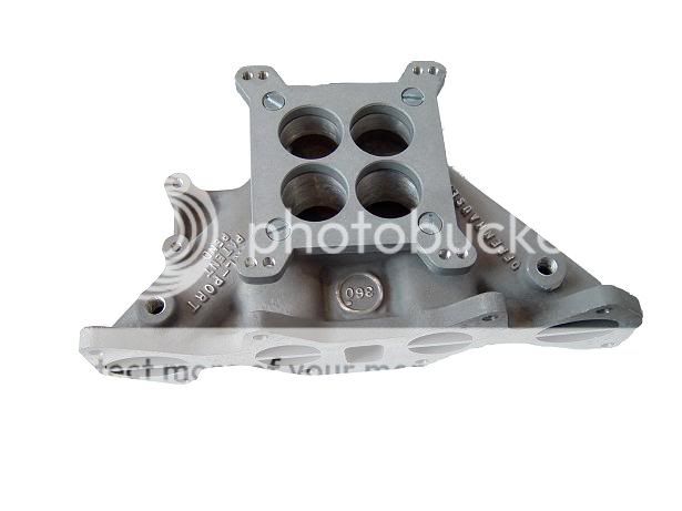

Itlives, is this the intake you are looking at?

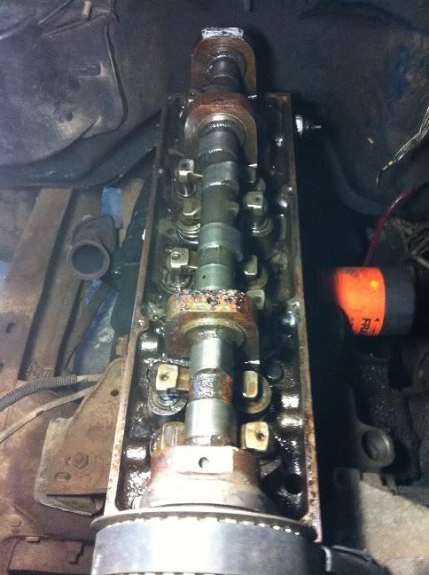

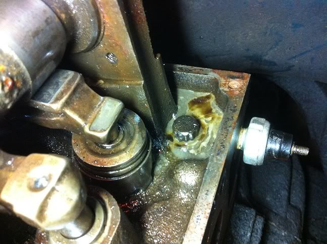

I felt inspired after much reading and research today, so I decided to go rip into my Ranger and take all the stuff off the intake side of the engine. When I originally bought the Ranger, I was told it blew the head gasket and the old man that owned it at the time tried to tackle the project himself, but got sick in the process and was put in a home. I was also told he had replaced the head gasket, had the head rebuilt, and the timing belt replaced but just wasn’t able to put it all back together. After getting into it, I confirmed that it had been taken apart prior due to every bolt I loosened was not tight at all (made for easy disassembly though!). I also realized that I think I have been lied to and that the head was definitely not rebuilt, or look like it had even been off since the head gasket blew.
I’m not too worried about it though, my head was the “Ranger oval type” that most likely would have cause fuel pooling if used with the OMC D port intake. Now I am planning on getting a rebuilt head with the proper wide D shaped intake to accept the OMC intake. The wider D shaped heads were from passenger car and marine applications correct?

upnsmoke- I was looking at that intake, but now, I think the the other one I referenced to would be better for everyday driving. Since it uses the 32/36 I already have, it'll be easier on my wallet and still have enough go to pull te camper.

One of the problems with the offy intake is that it has quite big ports making for poor bottom and mid range.It works great for what it is for,rpm racing,but not the best for the street.The 88-89 EFI intake is a little better choice.Same thing with the head,if you get one with the smaller ports,you will have better throttle response on the street.
